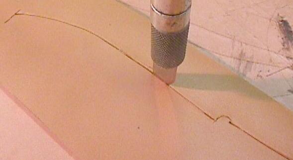

Nice looking sheath,
I think what Dan is talking about is a little bit of a notch or catch in the welt for finger groves, gaurds, ext. to catch on when the knife is fully seated in the sheath, at least that's what I do. It doesn't take much though.

ahhh, i think i see now. you just poke the hole with a hole punch to make a more rounded hole thatn cutting it with the nife right?
I do on some of them :)
Pretty cool tutorial Dan, and a first class sheath, it gives me an idea or two I want to try out. Have you ever used a sharpened finishing nail to drill the holes? I like the results better than when I was drilling.
