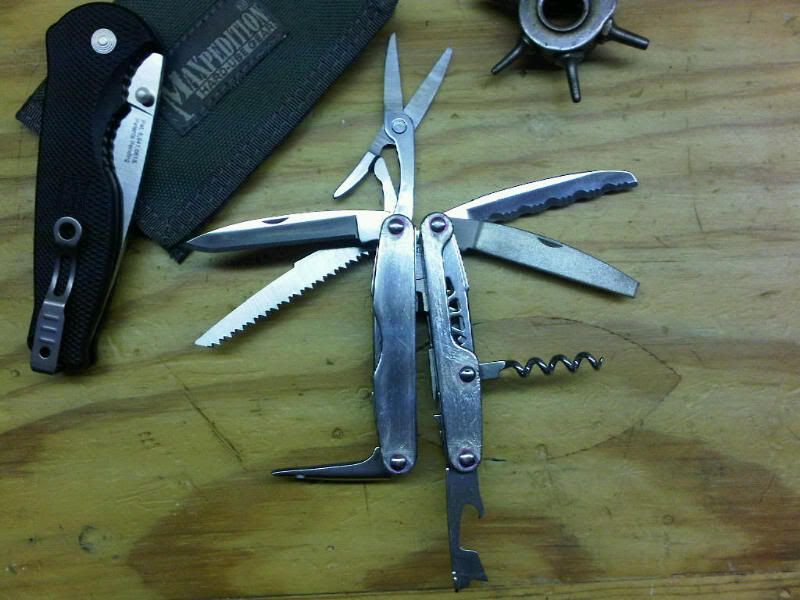

A while back I used a dremel to remove the anodizing from a Leatherman Juice XE6. I'd like to try a chemical remover the next time. I've heard that maybe hydrogen peroxide or sodium hydroxide (Drano, Oven Cleaner) might do the trick.
Any ideas?
thanks

Easy Off oven cleaner works just fine.
Keep an eye on it, so it doesn't ruin the finish.
Hard anodized pots and pans can't be washed in the dishwasher 'cause the caustics in the automatic dishwashing powders and liquids will take the hard anodizing off the aluminum.
Sodium hydroxide (drain cleaner, oven cleaner, lye) dissolved in water eats anodizing quick enough, and it is a deal nicer to work with than nitric acid. Use a dilute solution and wear protective gloves and glasses.
In the way back machine I used the old school caustic oven cleaner to remove regular anodizing. Like others said, clean well of all waxes and oils and then apply. Not sure if it'd work on thick hard anodizing, tho.
