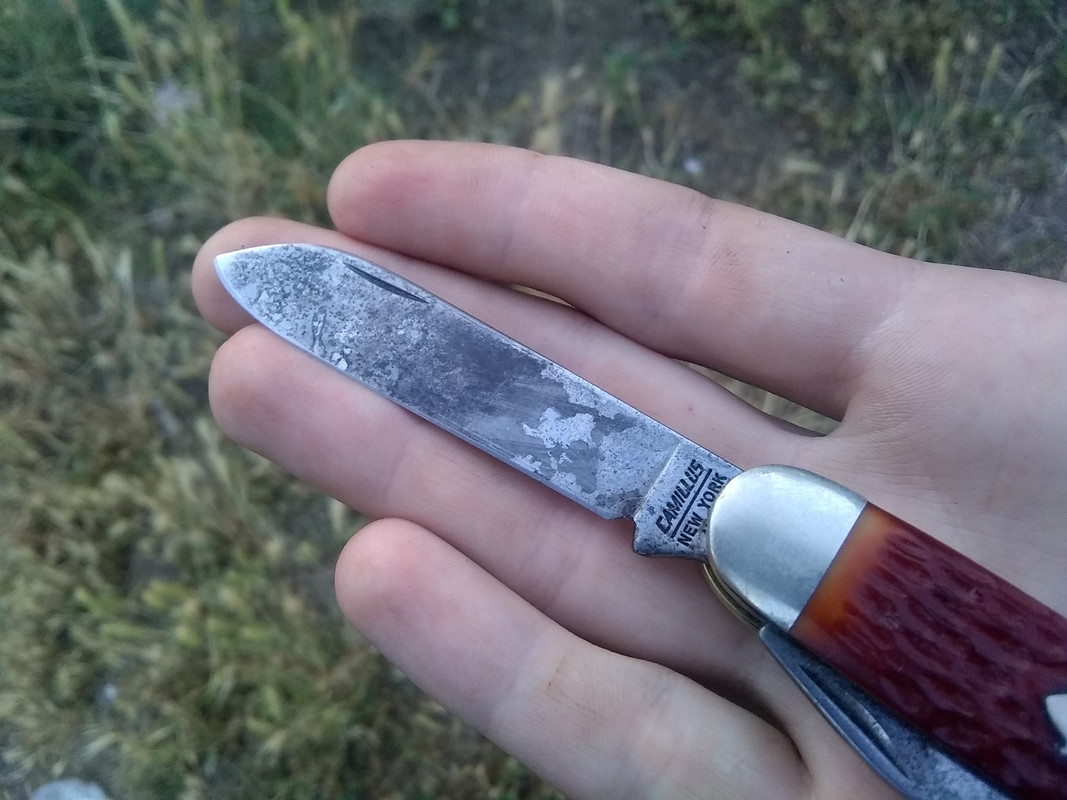

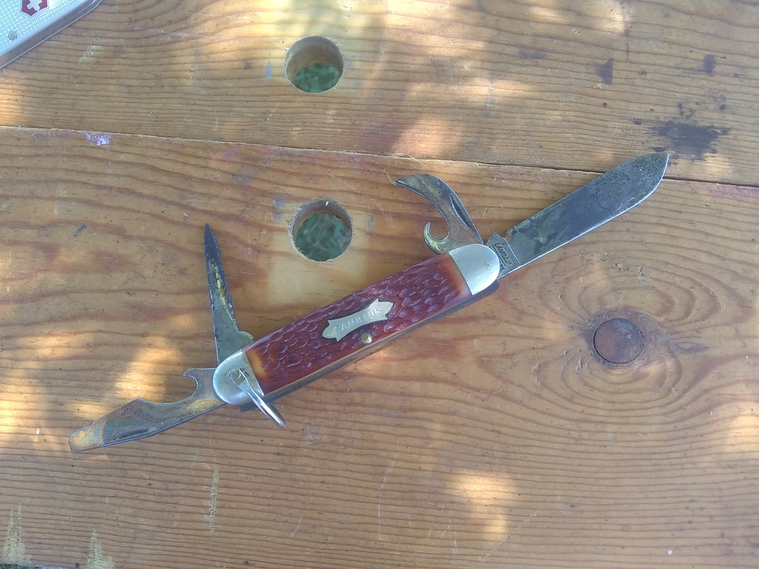

Here's one i just did last week.
It didn't have a ton of rust, but there was rust none the less.
Now a the rust is gone with all the patina remaining, and it doesn't look like people assume when any kind of motorized wire brush was used.
It works great if you don't go crazy, and don't run the tool full speed either. You've gotta wear eye protection either way but the little rotary tool brushes spit wires like crazy on high speed.
