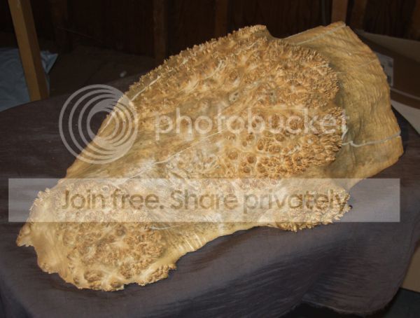

This is just a quick and easy to cut a burl cap into blocks.
The wood I am using is a maple burl cap.

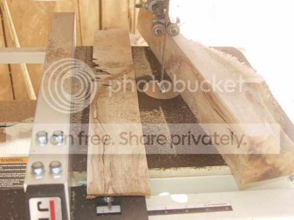

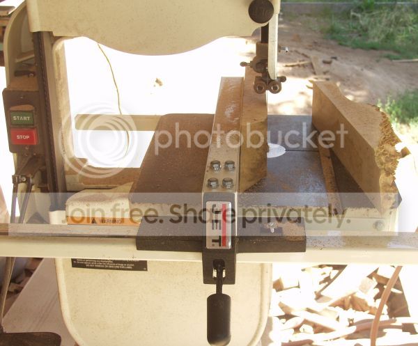

To cut it I am using a 14 inch wood cutting bandsaw equipped with a fence.

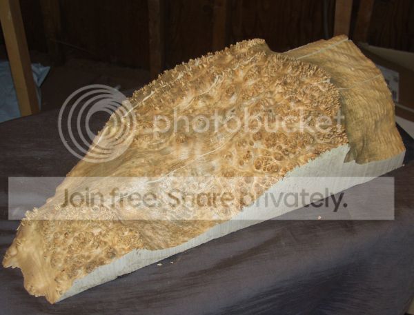

This is the burl cap.

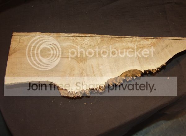

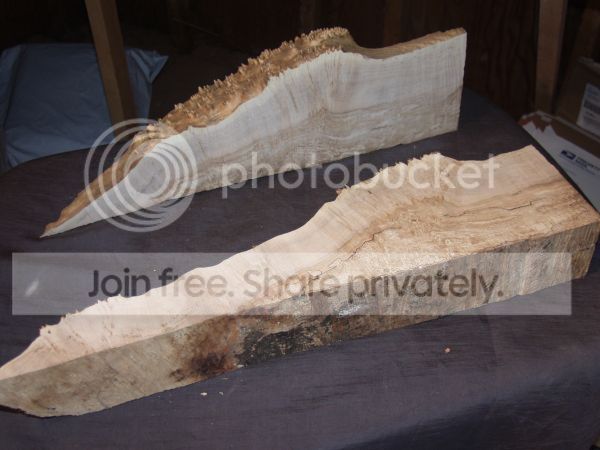

1st thing I did was cut a straight edge along one side following the grain in the wood.

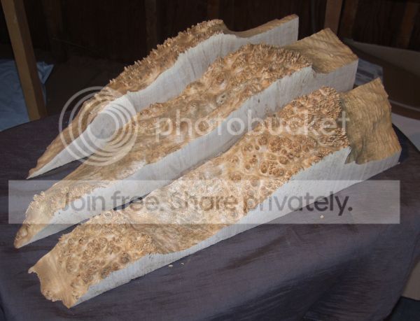

This gives me a straight edge to go against the fence on my bandsaw. After that I cut the rest of the burl cap into strips.

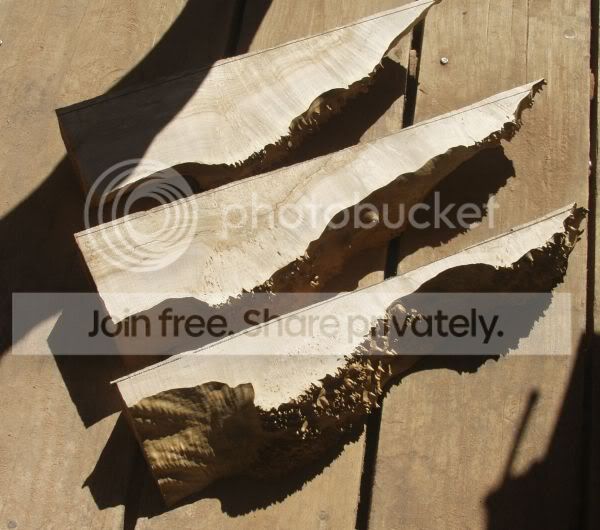

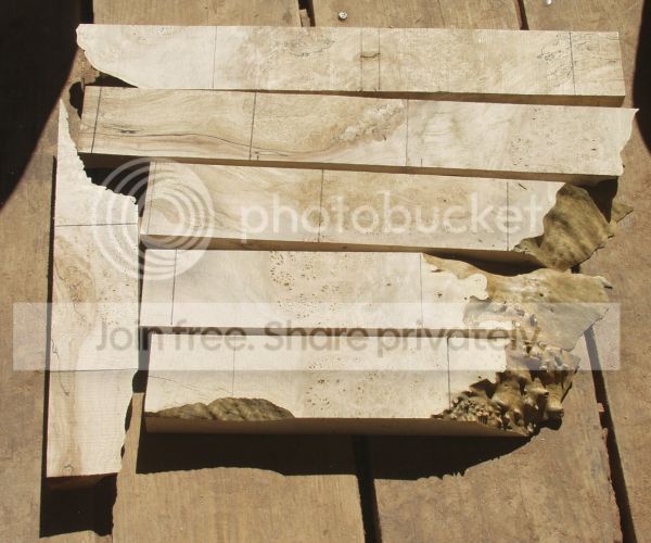

For the next step I laid the slices on their sides and marked them to cut a straight edge.
Then I trimmed the straight edge.

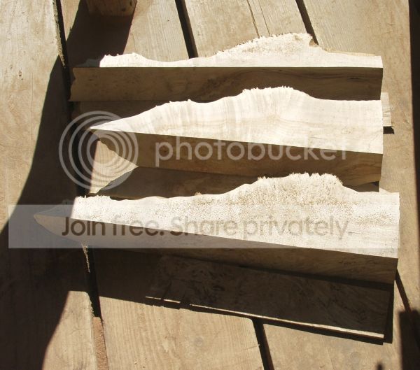

This straight edge goes against the bandsaw fence and I cut strips the thickness I wanted for my blocks.
Now each of the slices have been cut into strips.

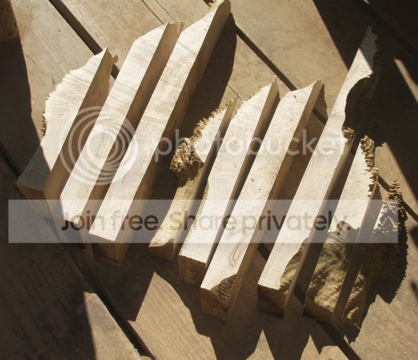

Finally I mark the strips where I want to make my cuts for blocks.

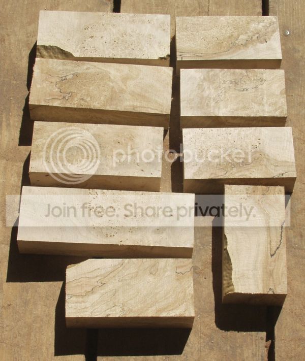

Then I cut the blocks.
I cut everything bigger than I need so I can do further trimming to remove any more flawed areas and show the best figure.
I would rather waste a lot of wood and get 6 really good blocks, than it is to cut just for quantity and get 12 mediocre blocks.
These blocks are not for sale. This was cut up only to show you guys an easy way to do the cutting if you come across a burl cap.
Do you use a plywood sled for the initial straight cuts or simply guide them by eye along the line you've drawn?
A sled would be a good way to do it.
I spend so much time on the bandsaw that I just do the first straight cut free hand.

Thanks for the pictures Mark! How long has that burl been drying?
This was about a year old cap I had set aside and forgotten about.
Now I have changed how I do things.
Seems if I cut them while fresh and put the blocks in my dehumidification kiln I have less waste due to cracks and movement.
