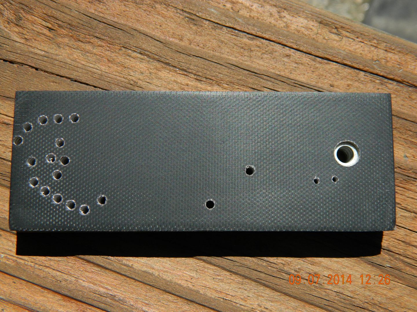

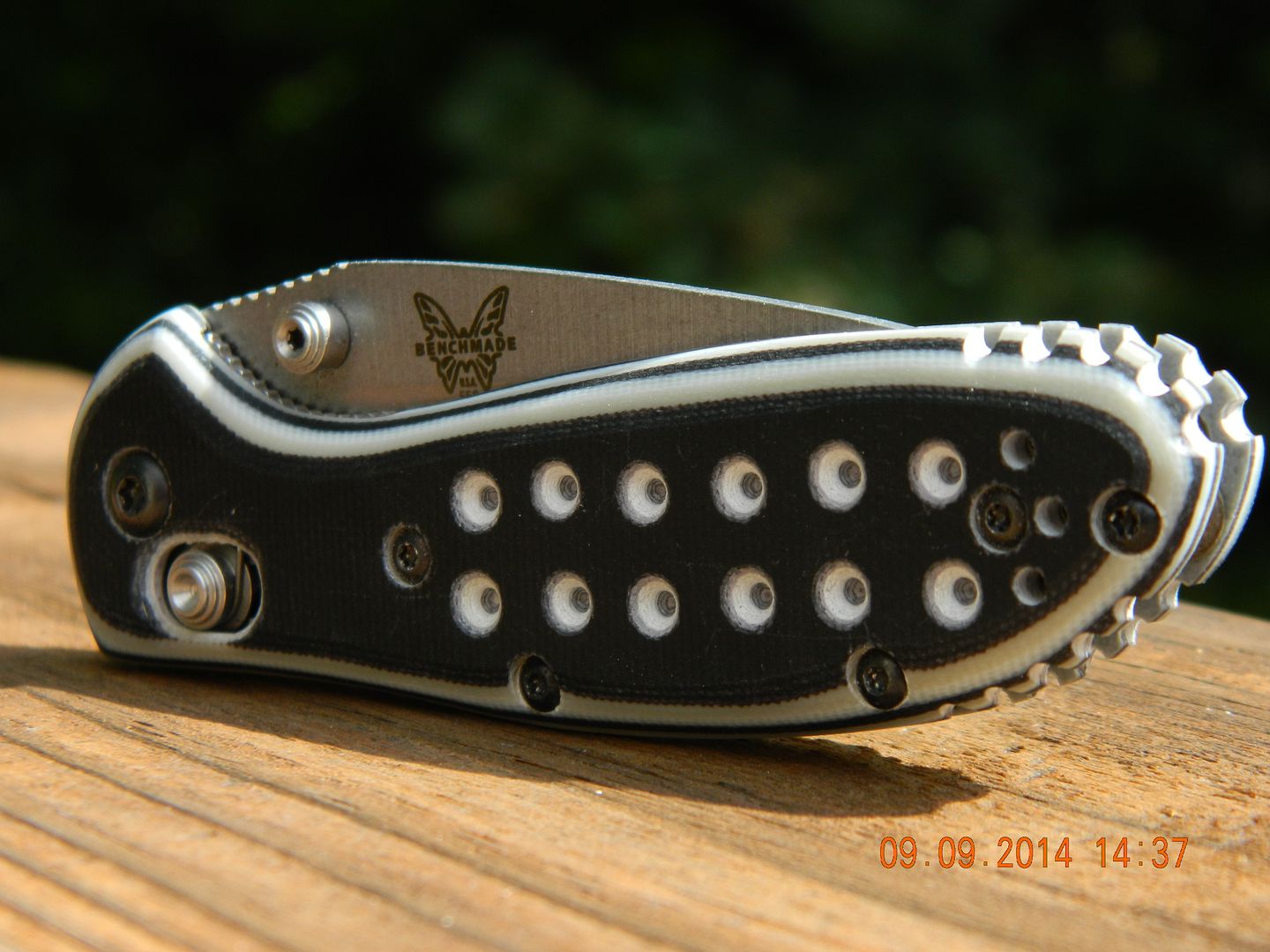

They put the original scale on the blank they are gonna use, trace it out, then they drill holes where the jimping is. That way when they cut out the shape the jimping is already done
That makes a lot of sense, thanks.
