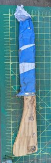

Here's my current project. I stopped grinding the handle to shape when I realized this was just not going to work. I think the tang is too long and I need to come up with a new plan before grinding away enough olive wood that it is too late.
I would LOVE anyone's ideas, pleeeeeeeeaaaaase!!!
(I started a thread on this, too: https://www.bladeforums.com/threads/help-i-dont-know-what-to-do-with-this-handle.1818273/)
