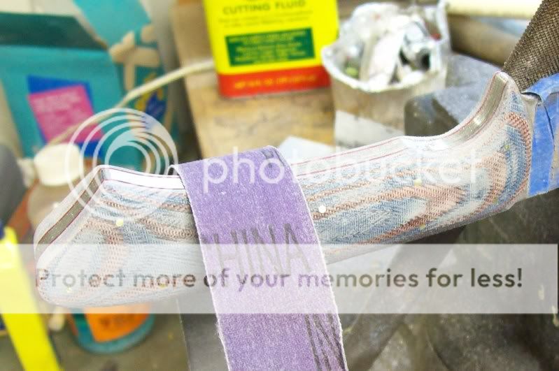

I make Mycarta using the fiberglass resin from Wal-Mart for user type knives. Some of it turns out great and I am able to buff it. Some turns out to be what I call dry mycarta and it's kinda fuzzy when sanding because the resin didn't soak into all the fibers. On dry mycarta, I shape it, sand to 320 grit and then seal it with the water thin super glue found at hobby stores. The water thin super glue penetrates every fiber in a hurry. Wait 10 minutes and sand with the next finer grit. Repeat until you like the finish and buff. The thin super glue won't fill in any texture but it does seal all the fiber and allows them to be finished without the fuzz.
Here's a pic of some dry mycarta on a knife I was making for myself. It was not one of my better attempts at mycarta and it was fuzzy.
I was able to buff the handle after using the thin super glue as I sanded it down.
The knife has gotten a lot of use since I made it and the mycarta handle is holding up fine. I don't take very good care of this knife and the handle looks better then the rest of it.
