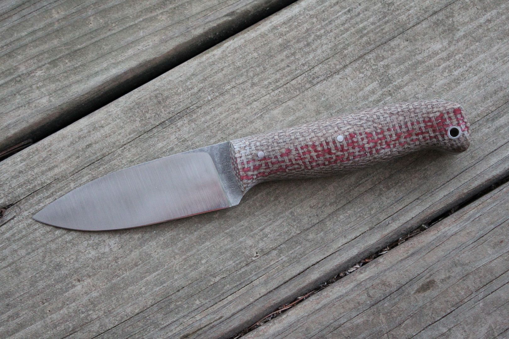

Ok, thanks! What about putting paste wax on after oiling it?I used WD-40 on my homebrew micarta. You will have to keep it oiled somehow, because there will be fibers from the burlap or paper that you use that will be exposed. If it is not oiled you will get a dull kinda dry look. I am not sure about the finish if it sanded to say a 1200 grit, you may end up with a slicker look and undoubtably the exposed fibers will not be as noticeable.
Ok, thanks. I appreciate the info!I don't know about home brew burlap Micarta, but oiling commercial canvas phenolic definitely changes it's look. Makes it much darker.
I generally like the look of it dry and freshly cut if it's tan or green, but that look is impossible to keep because the oils from hands will darken it.
I have found that running "dirty" Micarta scales in an ultrasonic cleaner with some floor cleaner can lighten it up again (I presume by removing some of the oil from the pores).
Ok, thanks to all of you. Mine is plain ol' brown burlap. I don't want any "fuzzies", I want it to feel like a piece of wood, not grippy cloth. How about polyurethane?
I think what's gonna work best for you is to do a grit progression up to 1000 or so. That's gonna refine the surface and leave it smooth. After you finish with the higher grit you could hit it with a buffer/green chromium to really smooth things out. Before going to the buffer I highly suggest searching "buffer safety" on here or the web, and read up. The buffer is probably one of the most dangerous tool knifemakers use.
I have heard that one way to make canvas micarta really grippy is the finish it up and then lightly bead blast it. I was told that the blasting eats away the resin between the threads slightly faster so you get a more textured surface. What I wonder is if you could do that and them give it a light spray of acrylic clear coat or artist's fixative to darken it up again without filling in the "holes?" Buffing make it looked but also makes it flat and slick.
