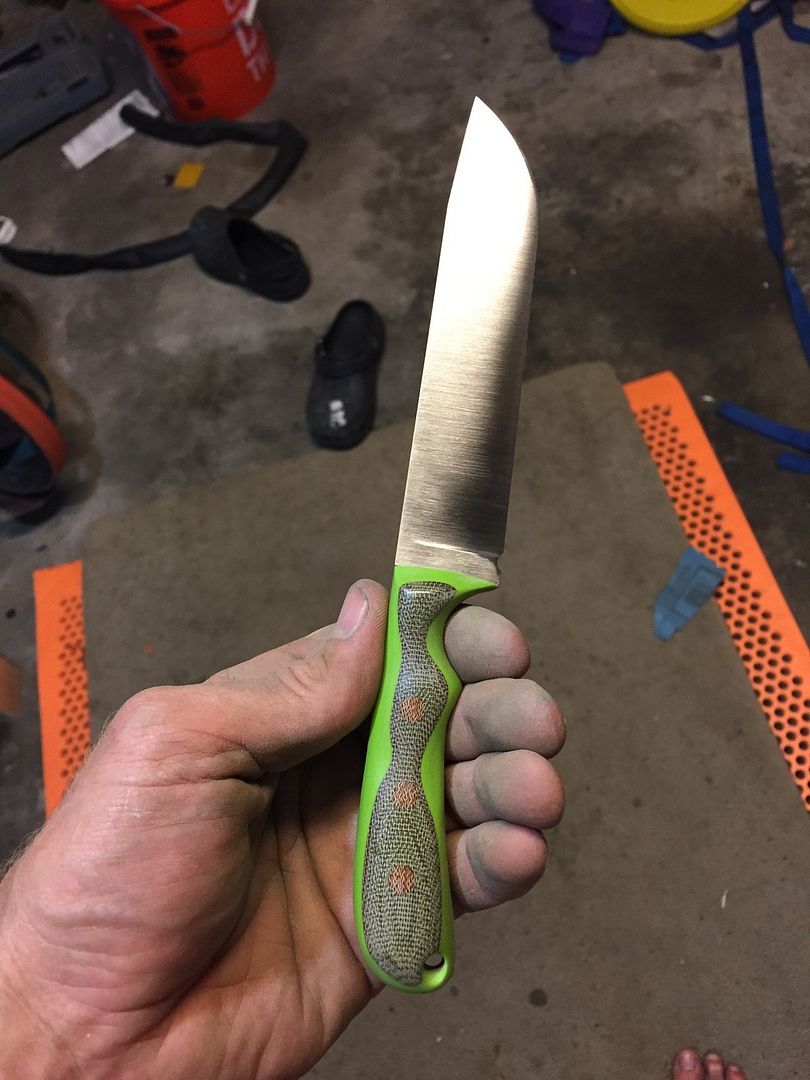

I sand to 320 at the finest. Some I will leave at 120 and some will go to 220. I do this by hand like I was finishing wood. No oil or wax. If it gets dirty and needs freshened up wash it in the kitchen sink with some dish detergent and it will look like the day you finished it.
This was some homemade burlap mycarta finished to 320. The fibers are very short and fine but when they get wet they still swell and stand at attention to aid in grip.
Ok, thank you! That looks really nice! I'll try out a few ways, see what comes out the best!

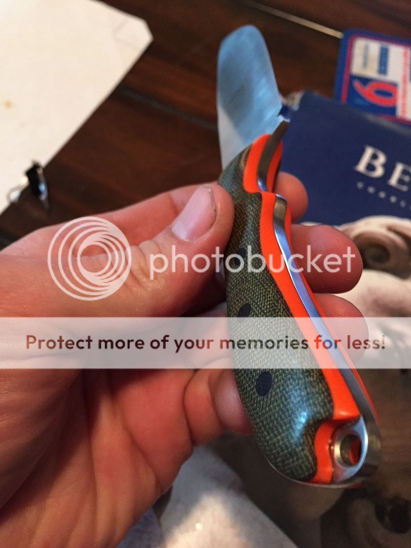

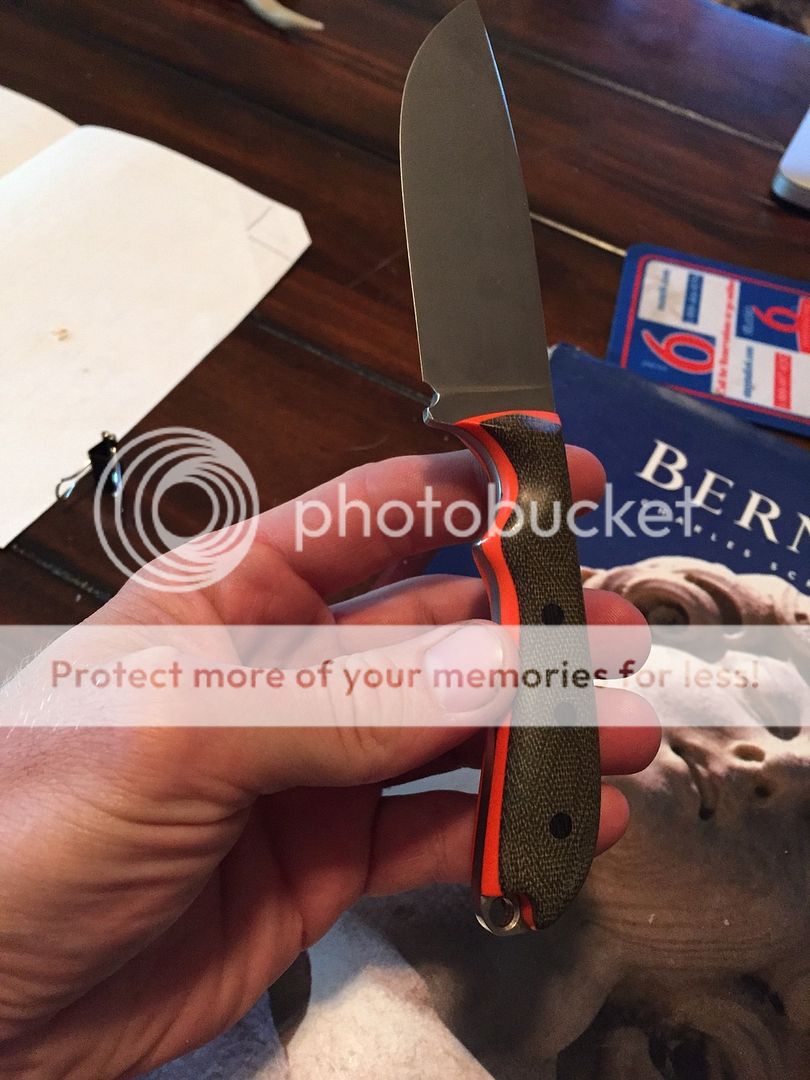

I've made a number of scales with mycarta. The burlap on this was only exposed until I sanded it. The pins presented no problems either.
I take it up to 1000 grit then follow by buffing using white (for plastics) buffing compound. The epoxy is close enough to plastic to buff nicely.

What do you use to get that brilliant green? And what kind of resin do you use? I use bondo resin and coffee bags I got from menards for .99 mine have big fibers like 3/32 or so. It's like string

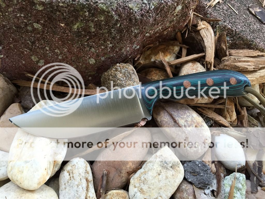

I do most my shaping on a 36 then 60 grit belt. Then hand sand normally 100,120,220,320,400 and sometimes lightly hit it with 800. Then end of the 320 and then entire time I sand with 400 and 800 I use windex. I then buff with a cotton wheel and white compound. If I want to short cut it I'll sand up to 320 then throw on some wd-40 and buff. Hope that helps some. Good luck to Ya. I love the way it comes out but hate how easily it burns compared to g10.

Epoxy pigment. There are a bunch of brands and colors to choose from. On that particular block I used yellow burlap and green pigment. The pin stock is the same burlap, only I didn't add pigment to the resin.
