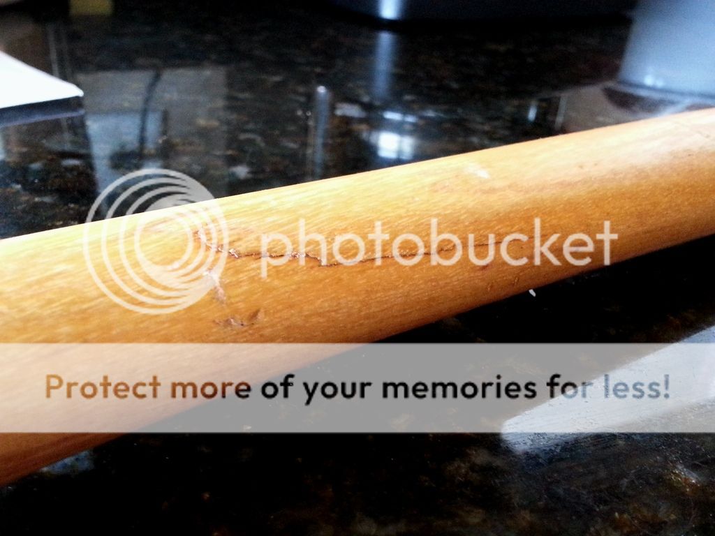

So I finally picked up a used GB Wildlife hatchet for a decent price. Seller did not mention this crack in the handle. I've put a little force to it and it doesn't seem to give. However, you can feel it pretty well in your hand, and if something were to get under it, I can imagine it would potentially lift up.
How would you guys go about fixing this so it doesn't get any worse in the future? Thanks in advance.

If it were mine and I couldn't return it, I would sand it down and seal it with an epoxy.

I'm not sure how I'd get epoxy in there, unless I pry it up a bit, which of course risks breaking that piece out. Is there a way to pin it like I've seen done with old gunstocks?

No, you can't pin it. You need to open up the crack and get as much wood glue in there as you can. Clamp it in a vise and have a buddy hold it open while you pack the crack with Titebond II or something similar. Then clamp the crack closed and let it sit for 24 hours.
If it splits completely when you pry it open then it was too far gone and needed to be replaced anyway.
This is a perfect example of severe wood grain 'runout'. It hasn't entirely failed yet (and maybe prying it open and gluing it closed will buy you some time) but in the long run you're best off looking for another handle.
Probably a thin CA glue is what I would use. Sand while glue is still wet. Its not a handle that takes a lot of stress. Might never fail at that location.
Looks like an accident waiting to happen. I'd take a dremel or a gouge and cut the sliver back then fill with epoxy and sand smooth. I'd also get a replacement handle cause I tend to put a lot of twisting or lateral force on my handles and I think I'd end up splitting the handle.

True it's only a hatchet handle but nevertheless this is an inferior piece of wood. When grain seems to have 'let go' spontaneously I immediately figure that the tree hit the ground really hard at the location where that blank was sawed from. You can't fix that!

I've repaired several cracked handles with wood glue. I've never had one fail at the glue joint. Before choosing to glue an axe handle you better make sure that the handle is worth gluing - i.e, that it doesn't posses bad runout or some other flaw that makes the handle inherently dangerous to re-use.

Lots of factors go into getting a good strong glue joint. If it is glued up right, clean joint with the correct amount of pressure and aligned correctly with a correct glue then the joint should be as strong if not stronger than the adjacent wood fibers. But, it is already established that the grain runout is weak. So there is a chance that the grain above or below the glue joint will subsequently fail. Lots of people have shown that, under ideal conditions, the glue joints can be stronger than the wood. And if it was all I had, I would not hesitate to do the repairs suggested. If you wrap with wet rawhide or sinew you might wear gloves when using the hatchet.

Lift it, glue it, clamp it, forget about it..
Yes that little grain raise is nothing.

This old octagon is back together. I am hard pressed to even find the glue joint and I know where its at. It may break again along the same plain but the glue joint will not. That break offered plenty of gluing surface and it fit back together perfectly. Not all can be repaired but some can.
