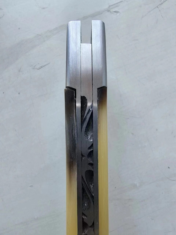

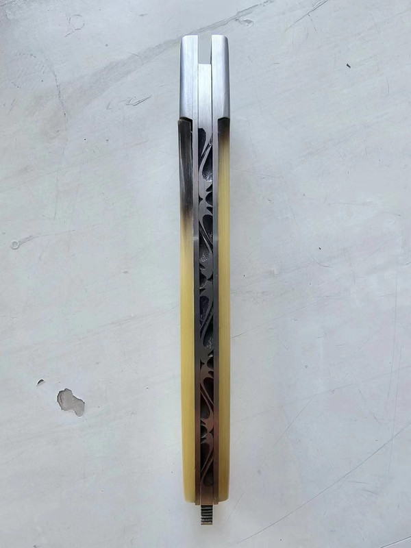

Hi there,
This Le Thiers arrived my hand last June, then I found this issue on the left piece.
At that time, the gap is not big, the touch and feel is not so discernable, but it becomes more easy to feel and easy to see.
When I handle it, my right thumb can clearly feel the uneven part between the scale and bolster, the gap is even more visible.
So, is there a way to fix it? (I tried to hard press it back but failed, so I think it's not as easy as just drop glue and press it back🤣)
Please advise.
Thanks.

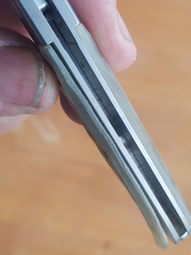

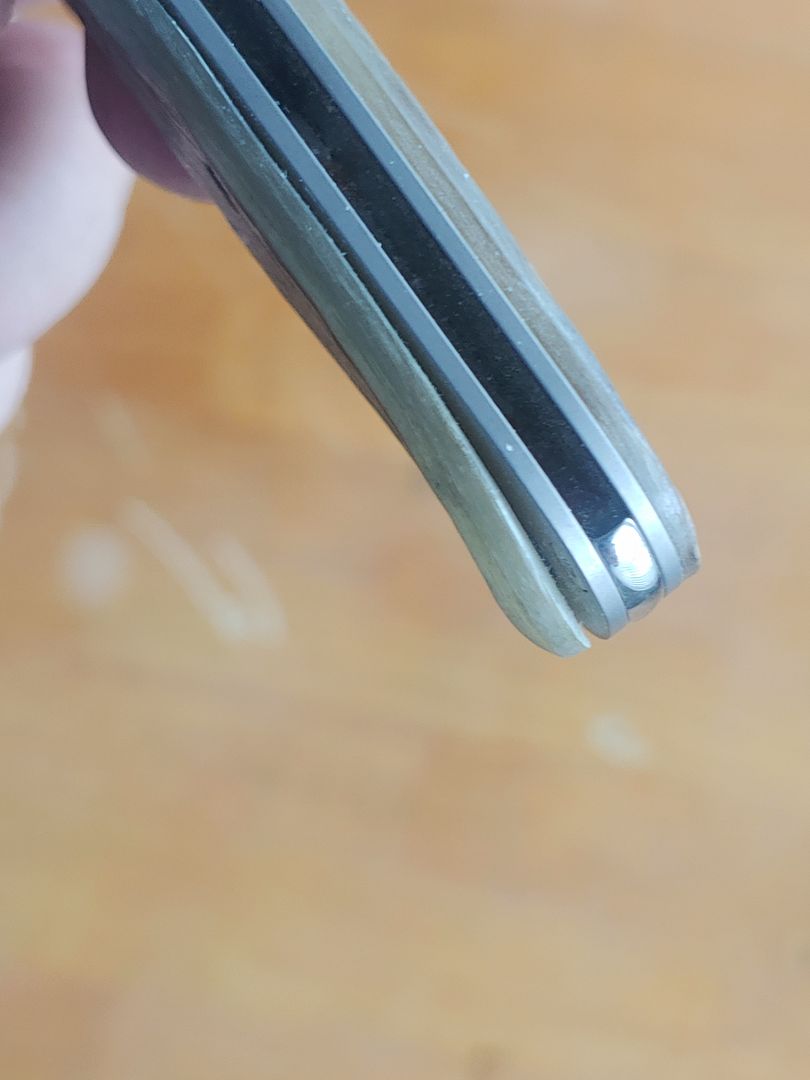

Why I hate horn for handle material. This knife was perfectly fitted when I got it. This is what it looked like a year later.
If it wasn't a Traditional Forum knife, I'd scrap the horn and make new covers out of something else.

Dextar the horn that is used for knife handles is cut and flattened during processing. The problem is that over time some pieces want to go back to their original curved shape and slowly start to curl. That's what's happening to your handle. There's not a hole lot you can do for this. You could try getting some epoxy under there and clamp it. Use a pony clamp so you can get one end in between the liners inside the knife. There tends to be a lot of pressure at that point and it may just pop out again though. You could also try getting some matching paper (black?) and slide some pieces into the gaps, then douse it with super glue. When dry trim it off and sand it down. It will probably be noticeable but you'll at least have a comfortable knife. Will Powers' advise is also spot on.

I had a nice Solingen made mini trapper that I liked a lot until the horn curled up.
