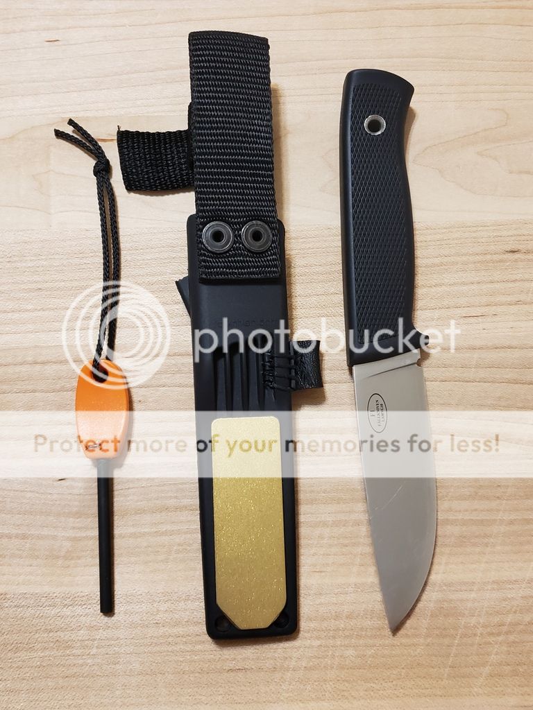

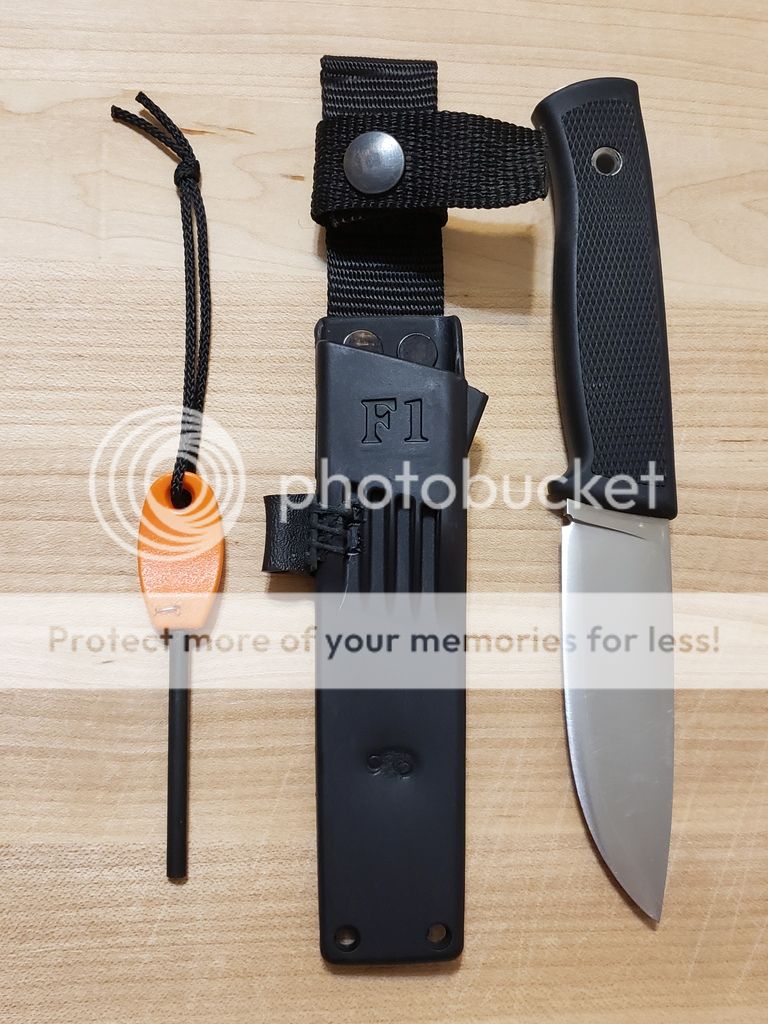

A lot of Fallkniven owners complain about the Zytel sheath so I just wanted to show how I fixed the noise problem and a few other modifications I made.
1. I tool a drill bit and heated it to red hot, then pressed it into the sheath a few inches from the bottom. The indention reduces the gap and the F1 now rides quietly in the sheath no matter how active you are.
2. I drilled a few holes in the side and custom made a kydex fire starter holder. I used saddle thread but you could also use some aircraft wire or something if you want it more durable.
3. I modified and attached a Fallkniven 3dt diamond sharpener to the back of the sheath so I always have a sharpener with me.
The sheath is waterproof, extremely lightweight, and with the few modifications I think a pretty good system for stock.
Glad you like it =) The noise really bothered me when walking around the woods and I'm not worried about cosmetics.
