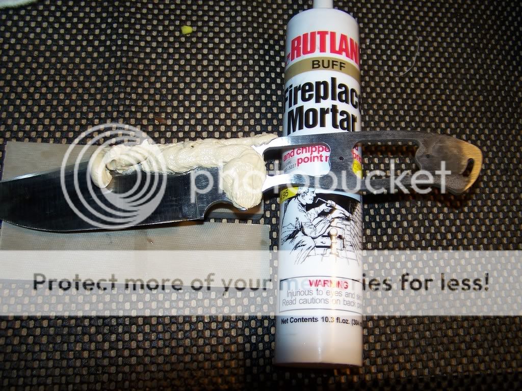

Other than Clay or satinite you could do this,
Works as good as clay or satinite and goes on easier, comes off just as easy with a putty knife.

Think he ment temper line not Hammon. I do get a good temper line in my 5160 or 9260 using the Mortor and doing a full quench, seems to work well for me thats how I did this one.

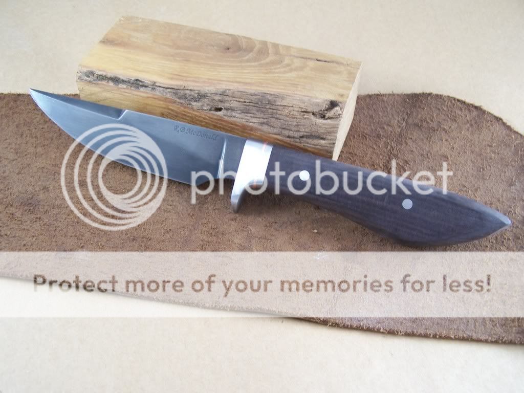

I have onley goten a quench line once and i was not even trying for it :rolleyes: here is what it looked like.
I think the onley way to get it is if it is over heated for to long and you start to get some alloy banding then when you quench it you see a line. if you notice the blade on it you can see a slite alloy banding going on. here in this picture it is stronger but no quench line.
