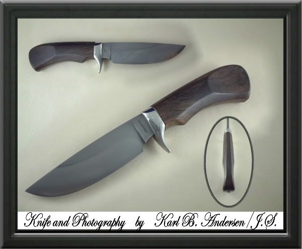

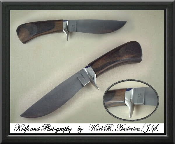

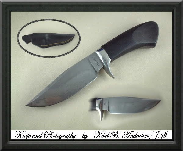

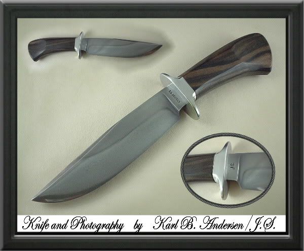

Take Bill up on his offer.
When it comes down to it, he helped to teach me this:
