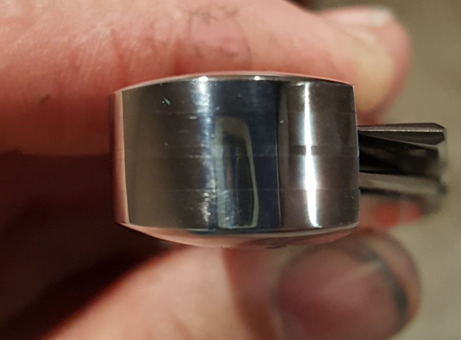

Basically the title, how can I get this seamless fit? Ultra flat surface? Method of fitting the bolster? Special grinding technique? Not put epoxy?
I want to hone my skills and I am seriously getting literally crazy. I spent literally 20 hours last week lapping a handle and bolster utntil they were very flat when tested on my granite plate + dykem. Also tested on new 123 blocks surface is flat, it seemed seamless. Then I pin everything, making sure bolster are flat on the tang, still no gap. Then I grind and it seem the finer I go the clearer the "gap" is visible (even tough you can't feel it with a finger). I am so obsessed by this problem it is getting ungesund (malsain in french?) Any tip? Is the epoxy overheating and expanding in the space?
Pictures would help.... what bolster material? Handle material?
The gap is on the joining adjacent faces of the bolster and handle?
Sorry I meant the tang, so the junction between the tang and bolsters. I use 304 stainless on mostly stainless knives. I was a bit tired yesterday, it is not that much a gap, more like a very very fine black line at the junction. It is visible everywhere where the tang meets the bolsters. I do not have this problem with the scales to bolsters junction. And I do not understand why because when I finish lapping my bolsters and my tang, both can stick together with just a drop of water, something I put nothing and they still stick, then why do I see this very fine line at the junction?20200115_054019.jpg

So it seems to me that you have a good fit. I’m guessing that what you want is the material to wash away so that there’s no line at all it seamless.
That’s not going to happen.
If you don’t like that joint line then you have to use a colored contrasting liner.
here's a Loveless knife from a world class maker, It's a stainless guard but the concept is the same, the two steel faces joining together show a line.
Fredy, I found a way around it by clamping my bolsters between 2 pieces of wood after peening and press the hell out of it in my vise, that way the pins enter wood and the bolster is put flat against the tang. A bit hard to explain but it works wonder.

I am just taking a pure guess here - but any time you have a junction between two different materials (or even the same materials with the grain running in different directions, when you sand them there will be a difference at the interface in material removal, and that could contribute to visibility of the interface......
Alex T. Alex T. he says a line will show....you could reduce the contrast between the two steels by hardening the bolsters to about 40 RC, you would have to change to a 416 ss

Flat and parallel will make the lines virtually disappear. Make your bolsters about 1/8 inch oversize then when you flatten you don't have rounded edges, then grind down to match the tang. you should see color difference but not lines.
This folder is 5 layers.
So if I "curve" the bolsters the line will show more than if I keep all parallel? Thank you sir!
I think what SBuzek means is that it is hard to make bolsters flat all the way to their edge using hand lapping, that there is a tendency for abrasive to form a bow wave (like a boat makes) ahead of the bolster and this removes fractionally more material from the bolster than is removed in the middle area. A bit like stropping rounding a cutting edge over time. Hard to see against a straight edge and hard to see using Dykem.
If the bolster is flattened oversize then when ground back you will be grinding into material that has a higher chance of being really flat.
Think that is what he meant...
Same probably goes for the tang where flattening with really fine grit could polish the edges a little more than the area 2-3mm in from the edge.
