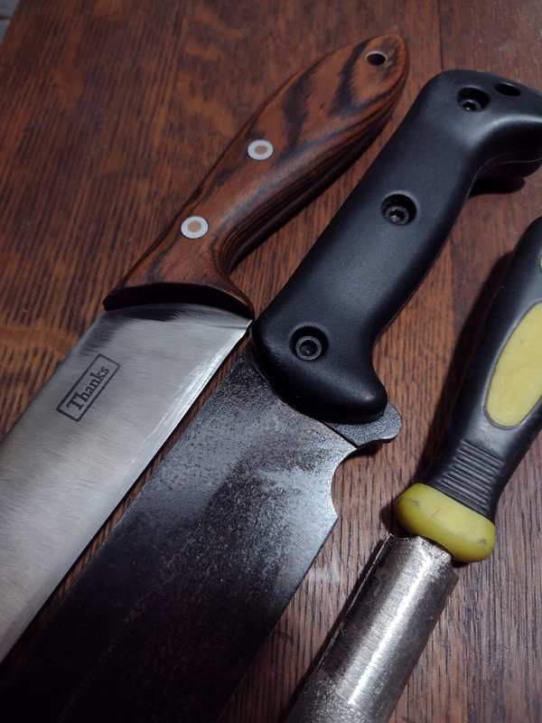

How to grind a blade a bit?

I've used a high-speed rotary tool like a Dremel to put choils into blades before. Always worked well for me. Just be careful not to get the blade too hot.
How hot is the hot threashold before damage can occur? Do you use a temp gauge of some sort to monitor?
I know you're not asking me but I think I can answer. Just keep a can of wd-40 or a water spray bottle and keep a steady stream of fluid to wash the heat away. At least that is what I do when I'm cutting metal. I just don't like the small dremel tools for this specific task I think.

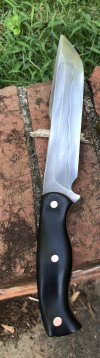

Don’t let the anti-choilers intimidate you into giving up on your dream(I say that jokingly they’re actually cool). I put choils of various sizes on all the knives I make and often laugh maniacally while I’m doing it. For small sharpening choils I use a dremel with chainsaw sharpening stones and a carbide faced file guide. I use a soaking wet rag and grind a few seconds then cool to room temperature with the rag and grind a bit more, then soak etc… I check with my fingers to make sure it’s not hot to the point of discomfort before soaking also. Below are some of the various stones I use or have used, the largest is 5/8” diameter. Now, for larger finger choils I use the small wheels on my 2x72. I like to play with choil size and placement for functional reasons and for the fun of it.IMG_0206.jpeg
I put a long sweeping plunge on this knife and ran the end of the choil out to the meet the cutting edge thickness so there wasn’t actually any “wasted” cutting edge:

Thanks! But I don't know what you mean. Could you explain that to a stupid person (me)?

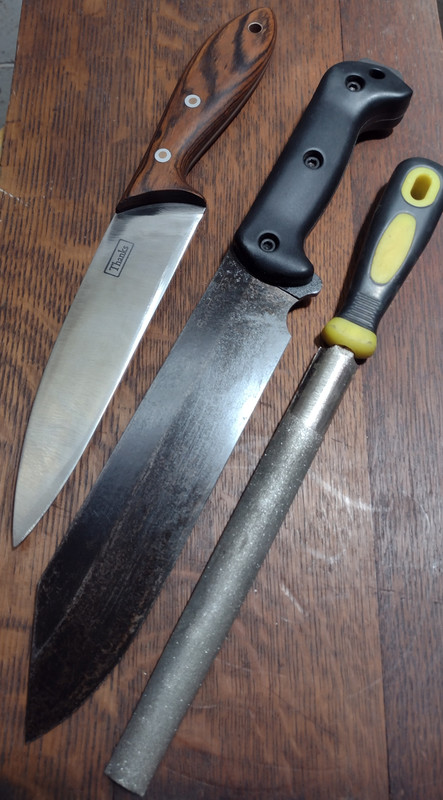

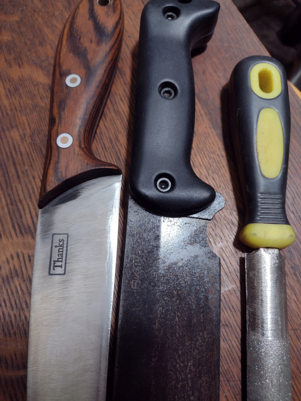

That's precisely what I'm aiming to do. I ordered a 16mm diamond file, it was cheap and always good to have so if it doesn't work that's ok. But I'd like to know exactly how you accomplished this?
I’m talking about a 2x72 belt sander like the one below. You can get an attachment with set of small ”wheels“ that come in various diameters to grind choils, fullers, finger grooves, etc. The sweeping plunge line was accomplished by running the belt off the side of the platen so it will create a natural sweeping radius in the plunge line. The farther you run the belt off the side of the platen, the more sweep you’ll get (to a point). The choil was created by using my 1/2“ wheel (I think) on the belt sander and cutting in to the depth I wanted then turning the edge into the straight belt as it was coming off the wheel. I’d think it would be fairly easy to accomplish the choil shape with a round file and flat file or just a half round file. I’d just file in the round/radius portion of the choil, then mark a tangent line at whatever angle looks good and file to it. Files are definitely less risky than power tools because you don’t have to worry about getting anything too hot a ruining the temper.
Just think everything through well and use a magic marker or something similar to lay out your lines before you do anything. Also tape off the blade so you don’t get any stray scratches. Don’t try to modify anything you’re not okay with ruining. It happens. I haven’t been making knives nearly as long as some of the others (I started in 22) who have commented on here and I’ve got a scrap bucket full of screw ups.
It was easy with a diamond half round file. They are cheap on Amazon
Should take, maybe a half hour or less
Hey thanks again for this tip. The file finally arrived last week, the temperature finally went up enough to go out to the garage today. I now have two knives that are much more useful to me than they were. Image attached (assuming I'm doing it right)
