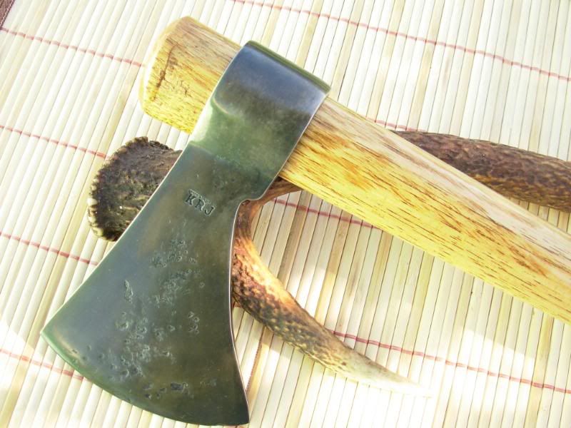

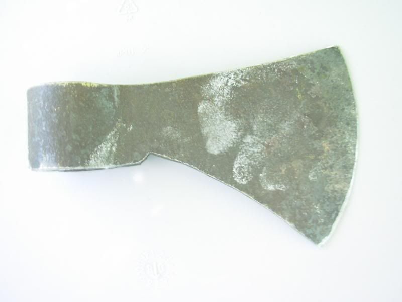

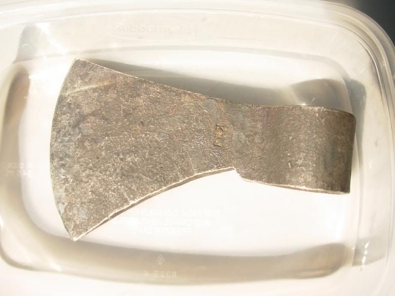

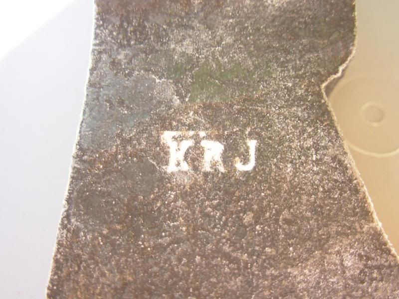

A pic of the hawk head as I got it. Also a pic of it with a bit of flour on it to show off the initials a little bit better. It's pretty rough looking. But Kieth make some fine hawks designed to be affordable and still highly functional.
Next pics...

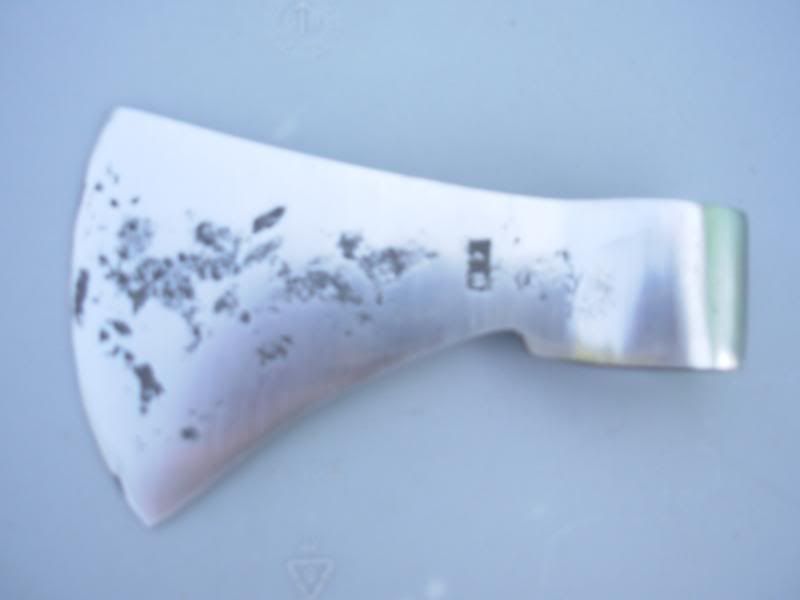

I took it to a 60 grit belt on my 2x72 grinder. I could have done the same thing on my cheap sears craftsman belt sander inverted in the vise.
I just moved up thru the grits till I hit 220. I took my time. I wanted some of the forge marks to remain. I just like the look. I could have spent some more time and money on belts and got it down to a completely smooth surface if I had wanted it.
Not a great pic but you get the idea.

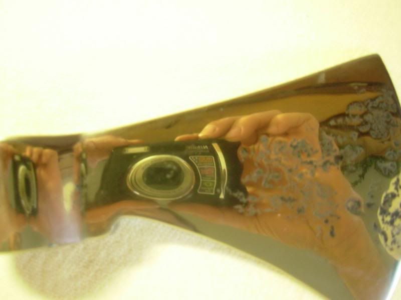

Then I started hand sanding...a lot. 220 grit the slowly up thru the grits till I finished at 1500. I gave it a buff but I don't think it really made much difference.

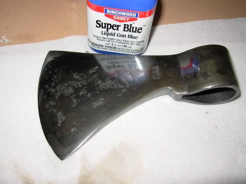

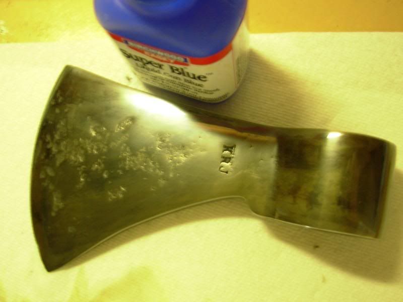

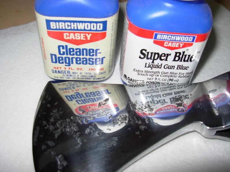

Here it is getting ready for the blueing process.
The head was cleaned and then rinsed in cold water. I used rubber gloves so I wouldn't get hand oils on it. I handled it by the eye anyway.

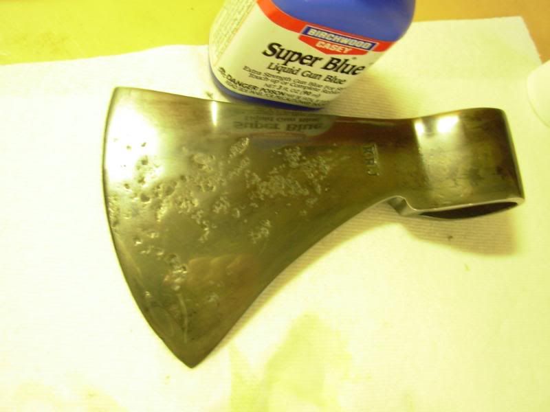

Here's a shot of the head after the first coat of blueing. Apply blueing, wait 30 seconds then rinse in cold water. The head got a light rubbing with a superfine steelwool pad between applications.
And after the second coat.
I stopped after the second coat. I like the look of this level of color. The first one I did was a bit darker.

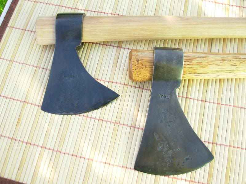

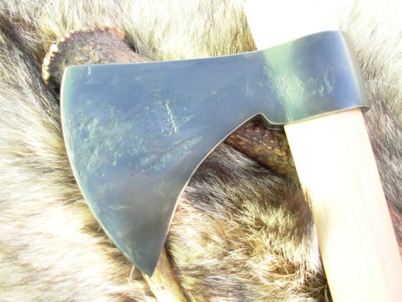

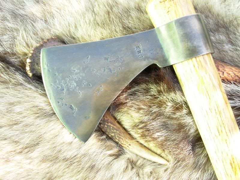

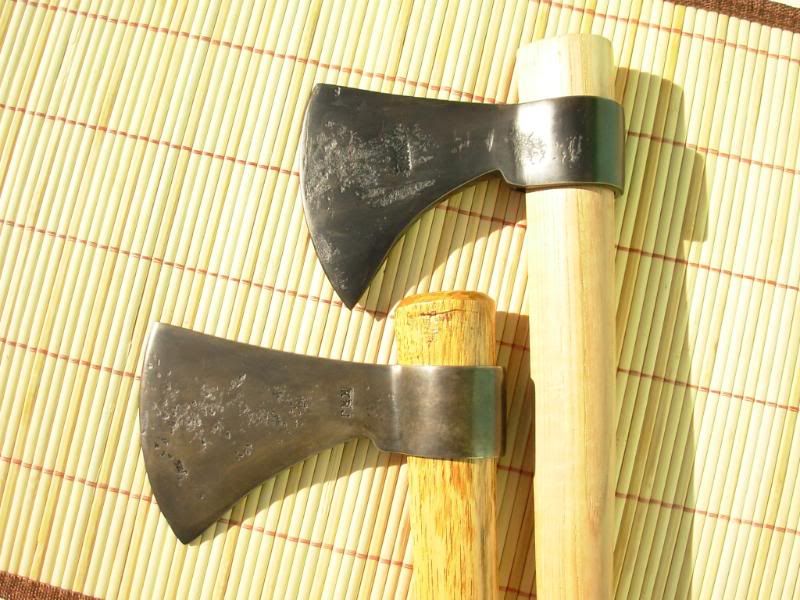

Here's some final pics of both of my KRJ hawks.

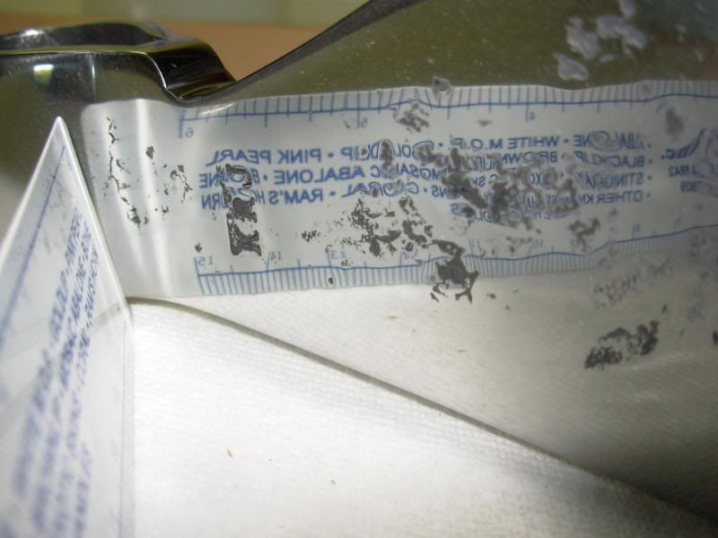

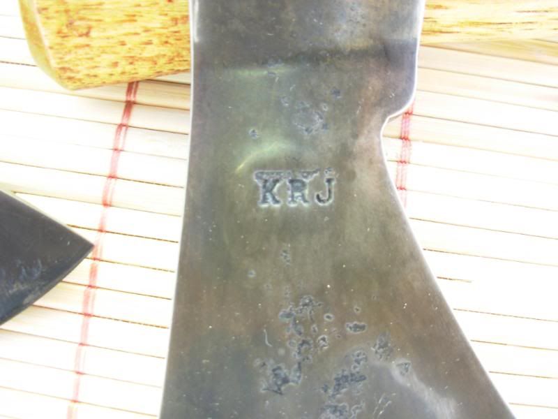

The makers mark now...
A couple of more pics...
Now go back and look at the fisrt pic and see what i started with. A lot of work but worth it.
