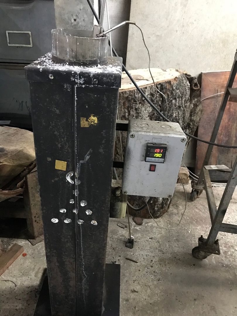

I use molten salt as quench media so the as-quenched hardness will be lower than normal oil quenching. But as I said I got 61 after 400F tempering with my protocol. From what I tested 1475F HT will give lower hardness and this has been confirmed from Larrin's article.

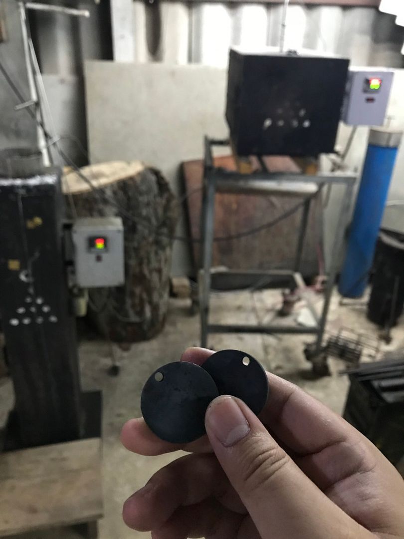

I use Bohler's R100 steel which is equivalence for AISI52100 and I have tried those 1475F austenitizing several times and I got lower final hardness compare to 1550F.
I know what and way was used salt quench .I don t know quenching speed of salt .He get lower final hardness with salt ....Make sense now my post ?
I use r100 as well. 1475° into parks yields 1 or 2 points higher for me than 1475°into McMaster Carr11 oil. Neither are as high a hardness as 1525 into parks or 1550 into mcmasterr, this 2 always quench 66 or higher. 1475° usually 2-4 points lower regardless of prior steel set up. Tested on surface ground coupons at 400 grit with a calibrated bench top rockwell tester.

I have heard from this forum that the 1475F austenitizing will yields highest hardness but after several attempt I know its not really true especially for R100 and Japanese's SUJ2 which you will always get significantly lower hardness like 2-4rc lower compare to 1540-1550F I normally use.
The quench speed of molten salt is faster than heated veg oil or medium speed oil but a little slower than fast oil. It can be use to harden W1 with auto hardened line effect tho.
The result I got have been duplicated by using both digital controlled electric kiln and digital controlled gas oven which has been calibrated regularly so I'm pretty sure about the conclusion.

Lets see if I can make sample pieces and ship it to you since I dont have milling and surface grinding machine to finish up the piece to exact size. I also have some interesting steel which would be nice to test, it is Daido's GO5. This steel is close to 80crv2 in composition and its seems to tougher than 5155 with higher wear resistance than 52100 (noticeable harder to hand sanding).
