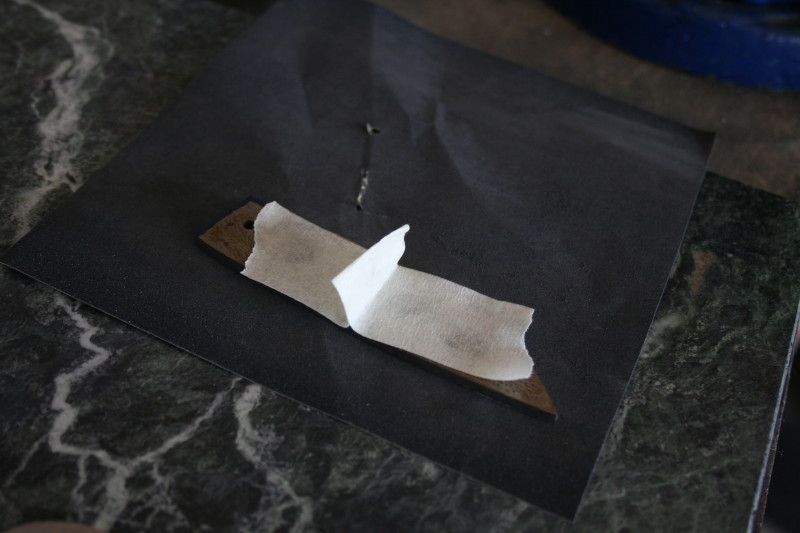

I use gorilla tape. Just tear off a few strips and make yourself a couple of "handles"
This stuff sticks like mad, comes off without leaving sticky crap everywhere, and I've held bowie blades with it in this manner to get the sides flat before.
You can use double sided duct tape. It will just stick to your finger (good quality stuff), no handle needed. Just make sure to keep the piece cool enough to handle or else you might get burned.

Thats why I recommended Gorilla tape. It seems to resist moderate heat. It wont come off if you have to dunk the piece in water, it's super thick so you can hang onto it without getting burned. I've ground the flats on all my knives in this fashion, vertically on the platen. Works on the disc too. I prefer this over a magnet.
This tape is super thick, strong and sticky. You can pull it right off without residue too. Most times I'm able to pull it off, and re-stick it on the other side with no change in stickiness/strength.
Its like duct tape on steroids. I've tried masking tape, regular duct tape, double sided tape.....all have left me screaming cuss words with burnt fingers.
