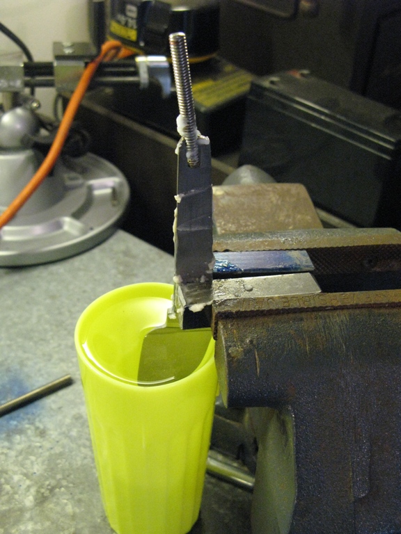

I'm about to extend the tang on a few damasteel blades, and need to keep the blade-temp down. All ideas are welcome :)

I'll try to clamp it to the anvil on my vise, with a long piece of brass on the top.
How about doing it like this?
Mike L.
I placed the blade on an aluminum plate, and clamped an aluminum block on top. Then I placed some wet paper on the rest of the blade that was sticking out . Work perfectly fine. Didn't look very professional though :D
Thanks for all your ideas.
