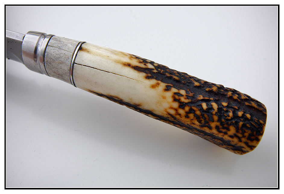

I myself "lost" the first stag handled knife in years this winter (despite the "soak-in-camelia-oil-and-place-a-bowl-of-water-in-the-safe" rountine I typically employ as well). Not the most valuable knife in the shed, but I can also see a couple of wooden handles shrink faster than ever:
I would appreciate any refinded mehtod of coping with changing humidity levels! Will try the rehydration routine on the wood handles asap, btw!
