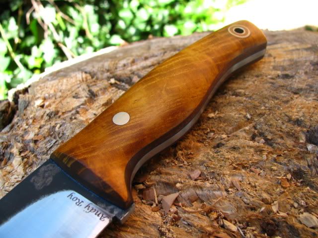

I know a few knifemakers that grind out the blade using files as well, from start to finish. It is a labor intensive process when compared to belt grinding, but the products can be comparable, and it shows great commitment from the maker.
Yep, those first two-tone handles were what initially caught my eye about Andy's work.When so many others were making what to me looked like improved Old Hickory knives, Andy was coming out with knives that had flowing curves, sex appeal, and a unique style all his own. He hasn't stopped impressing me yet.

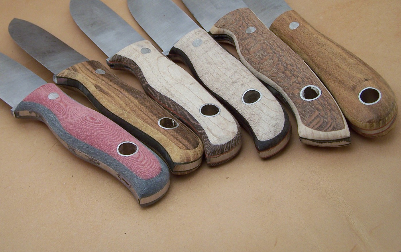

The epoxy serves two functions: Holds the handle material in place and seals the tang from moisture.
The pins or screws also have two functions: Holding the handle material in place and preventing any lateral movement of the material.
Another method of drilling the pin/lanyard holes is to drill the tang first, glue up one side of the handle material and let it cure. Then, drill through the tang holes and the attached handle slab. Glue up the second handle slab, let it cure and drill back through the holes in the first side. Straight shot every time. I think this is the way they do it in the shop now.
Great info! Thanks for sharing.
Chris tapes the pre-drilled blank onto the scales and drills the holes
Then he comes back in the office and scribes around the blank on the the scales on right/left scale
Then he goes to the grinder and removes the material just barely outside the scribe line
Then he shapes the fronts and tops of the scales
Once that is complete he rounds up a crew to help sand the tops and fronts...
Then the scales are flattened for about the 3rd or 4th and final time ( the other times happen during various other steps in the process)
Finally
Aubrey,Chris and Judy glue them up ,clamp them and and a final clean up
