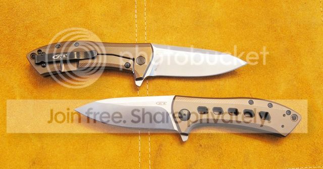

So I've had my ZT 0452cf for almost two years now and it has possibly been my most pocketed knife during that time period. However, the lock has progressively gotten worse and is slipping too easily.
Engages at about 60% but I can push it far enough for the detent to touch the other scale using one finger. As far as staying engaged I can feel the lock slipping just from hand pressure, and it very easily fails spinewacks. Not like hacking a 2x4 in half spinewacks, I'm just talking the weight of the knife alone allowed to drop from 4" off a table. Call it abuse if you want but none of my other framelocks do that.
I just don't trust it enough, so I'm wondering if there is anything I can do to make it have a slight stick like a ti+steel interface (or any other steel insert framelock thats actually designed well)?

I'd second the idea to send it into ZT customer service. If you are adamant about rectifying the situation yourself, have someone carbidize either the blade tang or the face of the lock insert. The layer of carbon will add a little mass so it doesn't lock up so late, as well as traction. Don't carbidize both the lock insert and the blade tang.
If it's failing spine whacks, the lock geometry is off and no amount of stick will make it safe.
Have you checked to make sure the pivot is tight? This can cause a lot of the issues you are describing.

Alignment is very important in the behavior of framelocks and linerlocks.
A lack of tension and/or overtightening of any fastener on the knife - yes, including pocket clip screws, can cause changes in lockup as well as how much the lock binds against the tang. Slight inconsistencies in scale, liner or pivot fit upon reassembly of a knife can cause similar effects.
I would check the tension on all the fasteners on your knife and use purple or blue loctite as necessary to fix them at the appropriate tension.

I'm thinking that might be the problem. The ramp is pretty steep compared to my other knives and its flat, so there might be a limited amount I can do. I've heard this is a general ZT issue so I think it might be that they make their lock geometry that way so that every knife locks up at 50% and feels solid (to maintain that "ZT built like a tank" feel) despite bad tolerances around the pivot and lock.
And I have sent the knife in for warranty for different issues, and it was returned with the same lock problems. Due to what I said above, I don't think this is an issue ZT can fix.

It's not spinewacks, I can barely tap the thing and it closes. Also now its slippery enough that when I push it to 100% engagement it just springs back to around 60%. All the screws are tight and it's centered. I'm going to send it in to ZT. Even if it's bad geometry in the design it shouldn't be that bad.

Finally got the knife back from ZT. The lock no longer slips and only pushes over to about 70% now, So I'll take that. However, I sent it out with a polished 18dps edge and specifically asked them NOT to sharpen it... and it is returned to me with a toothy edge that's got to be 25-30dps. :mad:
Are you sure it's the same blade?
May have been re-bladed for the fix.
