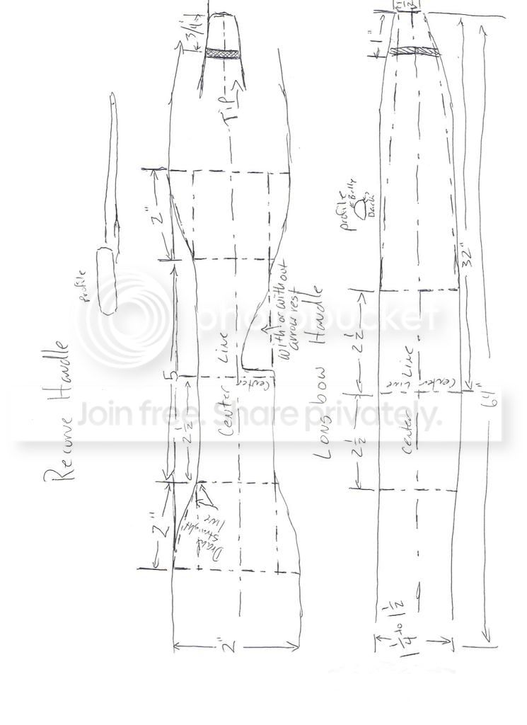

Fiddleback was requesting I send a drawing of the handle layout in my other thread. Since this is the final thread on the topic, I thought I would carry it over to this one.
