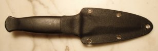

I say give it a shot. The pics attached are of my first sheath. I watched a video on this link and jumped in.
http://www.chiro75knives.com/tutorials/plasticsheath/plasticsheathtutorial.html
If you want a professional sheath, leave it to a professional. If you enjoy working with your hands and want to give a new hobby a try get after it. As you'll see from the pics my first shot is no masterpiece, but it holds the knife tight with no rattle and I made it. I have to say that I did have help with materials from a local Knifemaker named Mr. McDonald. I bought a small toaster oven for $19 at Target and a heatgun from a pawn shop for $25. Mr. McDonald hooked me up with everything else I needed. (Thanks Mr. McDonald) Check out his site if you have time. www.mcdonaldknives.com Great workmanship and an even better man. I was speaking with another maker this past week at a show. I mentioned how nice things worked out and how Mr. McDonald really helped me out. His comment, "Funny how that works out isn't it? That's the way it's supposed to be." The friendships and mentoring are another part of what makes knife collecting a great past time. Good luck with whatever you decide, but if you do make a sheath post the pics.

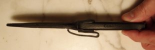

Hi pete,
Thanks for the kind words about my homemade sheath.
I used to make some kydex sheaths for my local friends and some for US buddys since six years ago if my memory serves me well.
But I have not made sheaths (maybe one or two years now) due to the day job and degree study concurrently.
With some proper tools and equipments you can make good sheath by yourself.
But just like other's commnets, professional sheath making need experience and a lot of practice. David Brown is a good source for sure. :thumbup:
But in my humble opinion, the best part is do-it-by-youself. The feel is great when you make some thing really work, no need to be fancy or multi-function.
