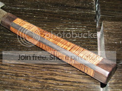

This is the handle on a kitchen knife that Stacy made for me.
I would say that he exposed the piece of wood's full potential.
i will for sure attempt to get some good pictures of it once its done. i actually bought the block from you maybe 4 or 5 months ago.
right now the stripes only show in the sun id like them to show all the time like your kitchen knife
