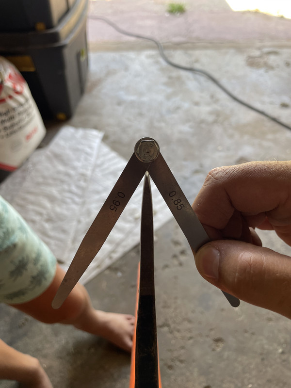

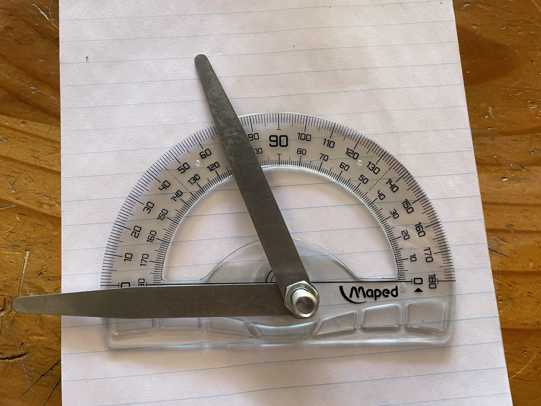

The Razor Edge Book of Sharpening mentions a simple method but one I have used for years. Its not absolutely perfect but it works.
Basically I took two feeler gauges pieces. Place it over the edge as below. Run it down until it catches. Place it on a protractor and you get an idea of angle.
Here is a store bought axe I applied the above logic to.
Compared to my heavily used Manix
