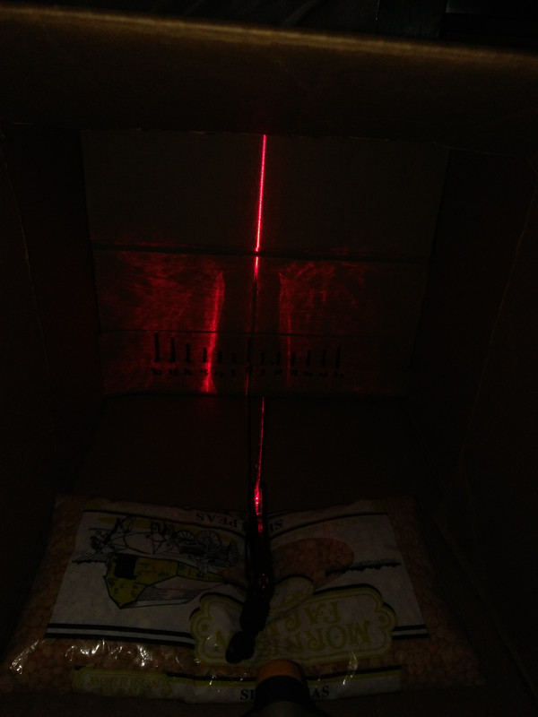

Do you have a one dollar laser pointer and a box?
jasonstone20 makes basic verhoeven version Re: Making Your Own Goniometer: How To?
Clip-on version
https://dschep.github.io/imgur-album-downloader/#/xTma1cJ
imgur.com/a/xTma1cJ
