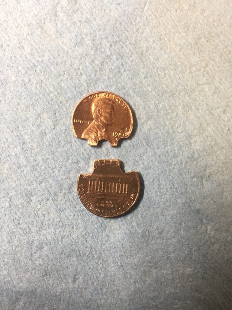

You can get creative and use a pair of snap ring pliers. It works for hinderers too. And also snap rings.
I made these for my hinderer's. Works great and only costs pennies!
