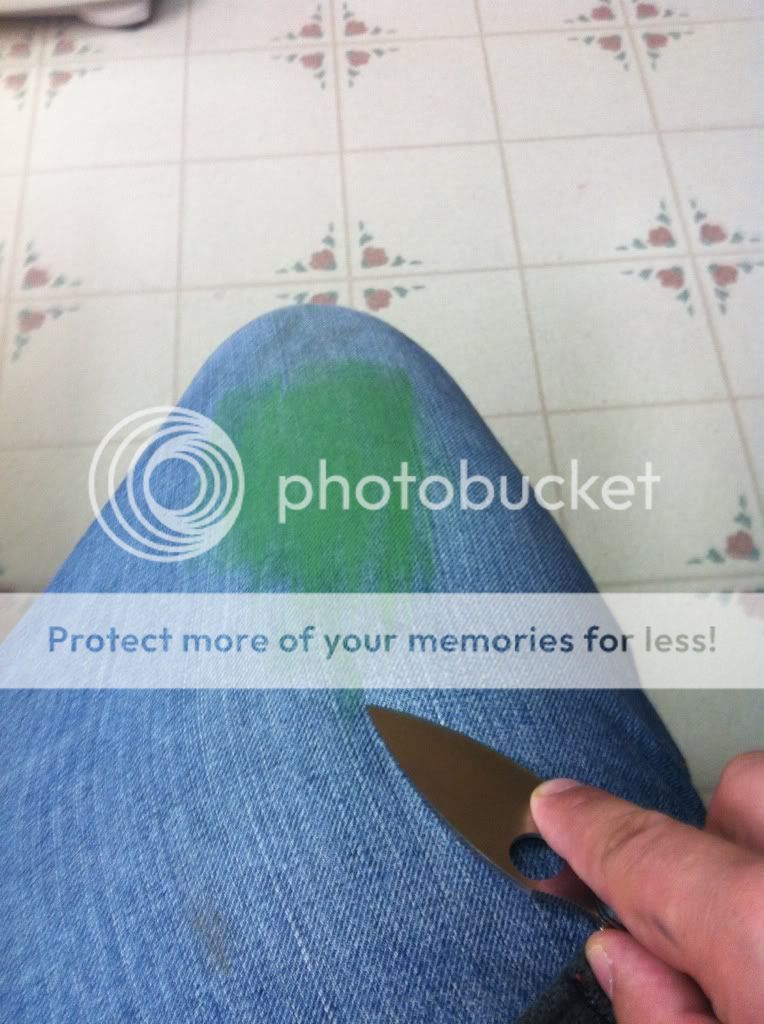

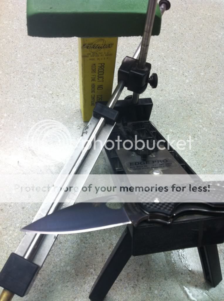

This is what I use for sharpening and stropping.
I strop on my jeans, two reasons, I can feel pressure better and it's a long surface that allows me to be more stable.
