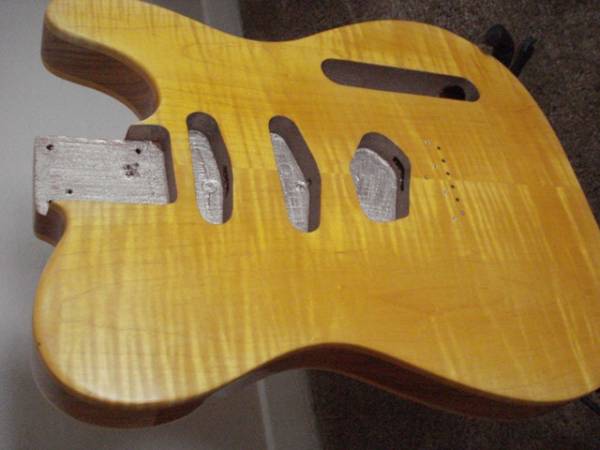

Does Tru-Oil work on maple?
Yes it works on maple too.
It brings out the depth in the wood.
You can still follow with a buffed wax after the oil if you want to.
Nice. The color on that guitar would be what I'm looking for, with a rubbed appearance.
