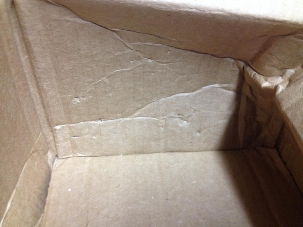

Here is how NOT to ship a knife (I received one I ordered on eBay this way).... Wrap blade in one layer of paper towel, tip exposed. Throw in box with three, yes THREE, crumpled up paper towels. Wrap tape once around seam of box, and ship. Results? Box gets crushed all to hell and shows up with the tip poking 1/4" out the end of the box. Also, along the way, the knife continually stabbed the end of the box in several places.... I was not amused. And this was a $200 knife... Jeebus.
^^^look at all the damn poke marks! And the totally crushed box! I was pretty pissed to say the least, but the knife had no damage so I didn't say anything.
