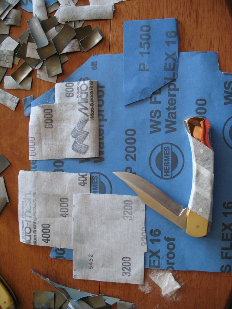

Make a work area and sit knife on soft cloth on table. First try and see if the marks will come out with a finer mesh like 3200 grade 2000 grade or 1500.If no success and the marks are deep you will have to use 800. Cut lots of small peices (as in pic) you will notice that the mesh clogs quickly with the brass or nickel so use lots peices in quick succession this will save you time.
If you have to go to 800 to remove marks you will need to then use 1200 to remove the light scratches that the 800 caused. Next 1500 then 2000 each one improves the last. 3200, 4000 and then lastly 6000.
These are the only grades I tend to use and there are some wide gaps between them (4000 to 6000). A way around this is just before using the 6000 grit use the 4000 with a peice that is a little glogged it will act a little similar to a 5000 grit.

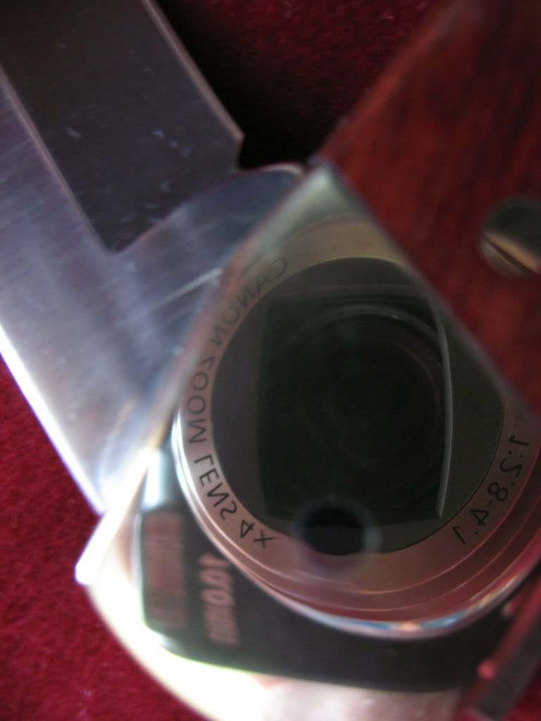

If you do it right the finished result is simply stunning. You should easily be able to see your reflection in the completed area.

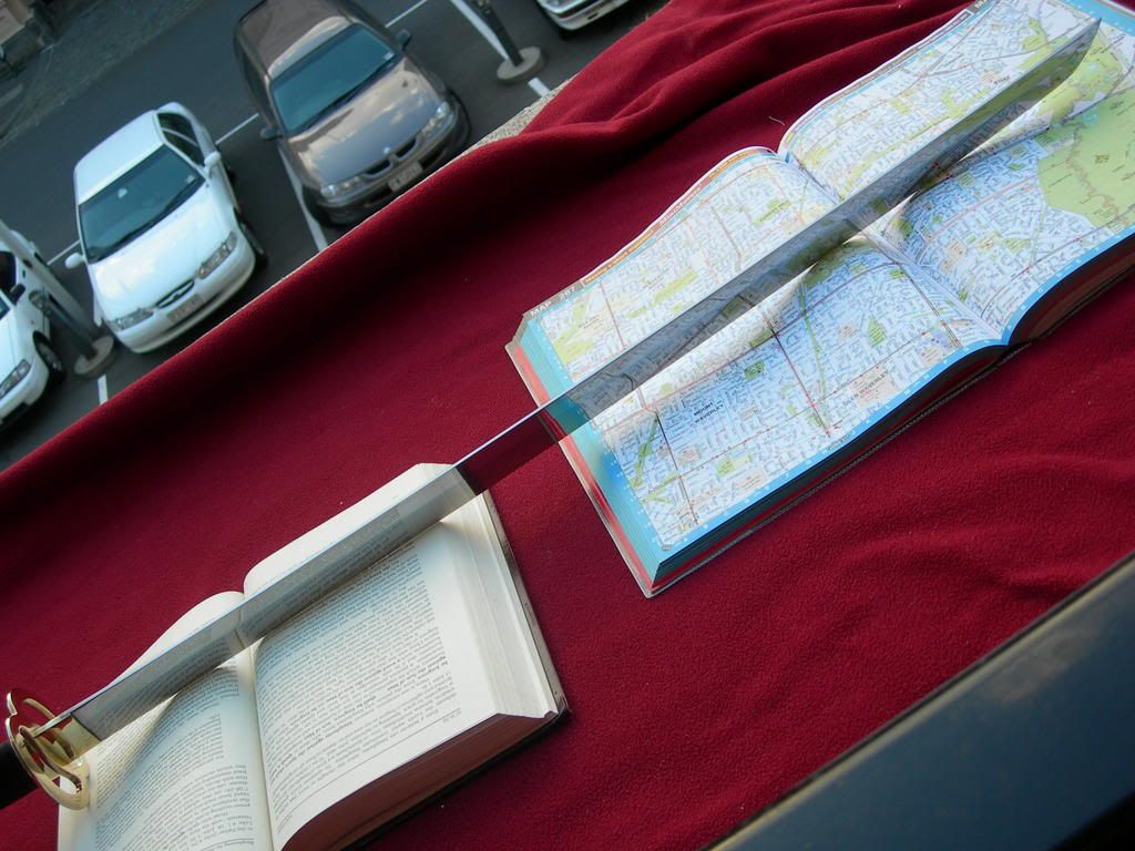

Below are some of my projects, see lens in pic. The sword below is all polished by hand this way (live edge) and is reflecting the book its resting on.
