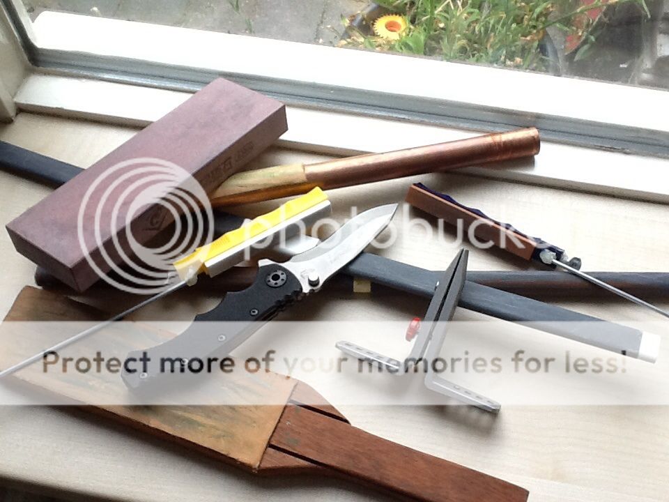

i got my lansky stone kit in and did 2 knives, not that bad. this weekend i'm gonna make the tubular strop and tubular sandpaper rods.
then i will give it a go on the pohl one. photo bucket account set up. ready to post.
Hi all, the tools I made and used. Using lansky got it reasonably sharp now.
Still thinking about the spyderco. Maby it's the angle,still not low enough .
Need to take off much metal then. Is reprofiling a good idea on a sharp maker?

Hello everyone Reading this,
Sorry to bump this old post of mine but I still struggle to get it sharp.
I now have a set of flat sharpening stones and a lansky stone system,
Also already made some pvc tubes with sandpaper and also used a kitchen ceramic / diamond steel
And am very careful when I touch it up but never get a razor edge.
On a side note, I think of reprofiling it to a 15 degree angle because maybe the factory edge is to steep for it to get realy sharp? Or the steel is to hard for the tools?
Where to begin... Anyone have this knife or sharpened a similar recurve?
It is a pretty steep recurve I think.
I love to hear your thoughts on my questions.

I'd start with the assumption in bold type above, and go from there. Thinning the edge grind to 30° inclusive (15° per side) or lower will always improve how a particular blade cuts. Most modern/tactical folders of this style (with thick/heavy blades) come with equally thick factory edge grinds, and never (or seldom) cut as well as they could or should. The hard part is going to be the thick blade itself; usually, a lot of steel needs to come off, to thin the edge grind. That'll take a while, but if you're patient about it, the results will be worth the time spent.
David
