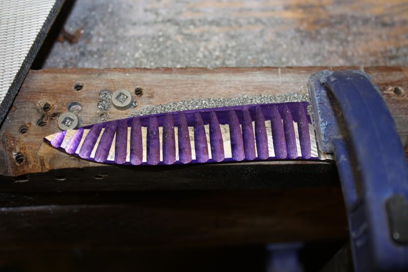

Don't try to imagine, look with your eyes where the stone contacts the blade.
Or mark up the edge with permanent marker, do one stroke, then look where the marker is being removed.
To maintain angle throughout the tip all you have to do is pivot the blade throughout the curved parts like this gif.
The little green square indicates 90 degrees to the stone , and always finish the stroke on the stone (tip remains on stone)
The key is to make sure the edge is contacting stone (look).
If you've marked up the edge with permanent marker, after you do a stroke or two , you should be able to see if you're hitting the edge in the curved/tip area, if you need to pivot more or lift the handle more.

Yes you can follow the curve without rotating the blade (although either works)... and you got it right... make sure you don't change the angle as you raise the handle. (There's an urge or belief that you need to also "twist" the blade to follow the curve, but this will lower the angle).
Try just placing the belly/tip area on the stone at the angle you want to sharpen at... raise and lower the handle without moving the knife back and forth... and you'll see how it contacts.
You know how pizza cutters have a wheel shaped blade? Imagine holding the edge of one of those on a stone at a given angle, with a dot on the blade at the point where it contacts the stone. Then imagine (still holding that angle) turning the blade. Think of what happens to that dot. It arcs up an away, but remains on the same plane the blade is tracked on. When hitting the tip, just envision that plane extending back into space and keep the handle/blade riding through it as you turn to sharpen the tip.
