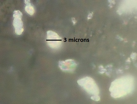

Do you recall what the micron size is for the compounds?
Averages to 3 micron grains - we estimated the size with an optical microscope.
Difference between the two is that White has more particles in the 6-3 micron range, while the Green has more particles in the 3-1 micron range.
If you check the safety data sheet for White and Green rouge (or similar buffing compounds), you will see that
White is just Alumina;
Green is 95% Alumina, and only 5% Chromium Oxide.
So in the Green compounds you have chiefly 3 micron Alumina, and little 0.5 micron Chromium Oxide.
For final finish I use a strop with CHROMOX, a pure 0.3-0.5 micron Chromium Oxide.
