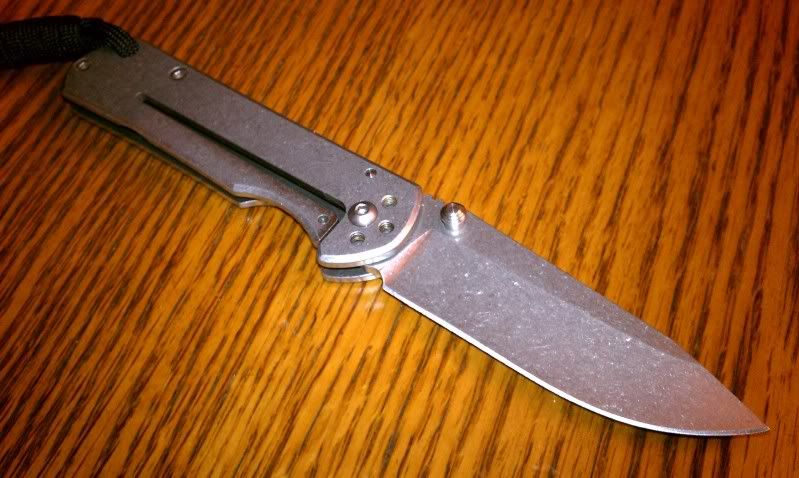

My apologies for calling the "Drying Machine" the "Washing Machine", just a bad habit of mine. Good all around EDC knife with perfect quality all around. Great knife for only $10-$15, I dislike the handles finish so in this video I will be showing how to stonewash the Sanrenmu 710. Blade is extremely sharp and has good edge retention as the stonewash process barely wore the edge. Total time to complete the stonewashed Sanrenmu was about 3 hours.

Picture Results:

I tried it and think with goog resoult on littel DOZIER KABAR.
I put a polish and shiny USB memory and one original stonewash balde .
only 1 hour of hand shake ;-)
What happened to that sanrenmu 710? Looks like it got dragged along a gravel road!
Just kidding, it looks great. Smooth and shiny is not always a good thing.
