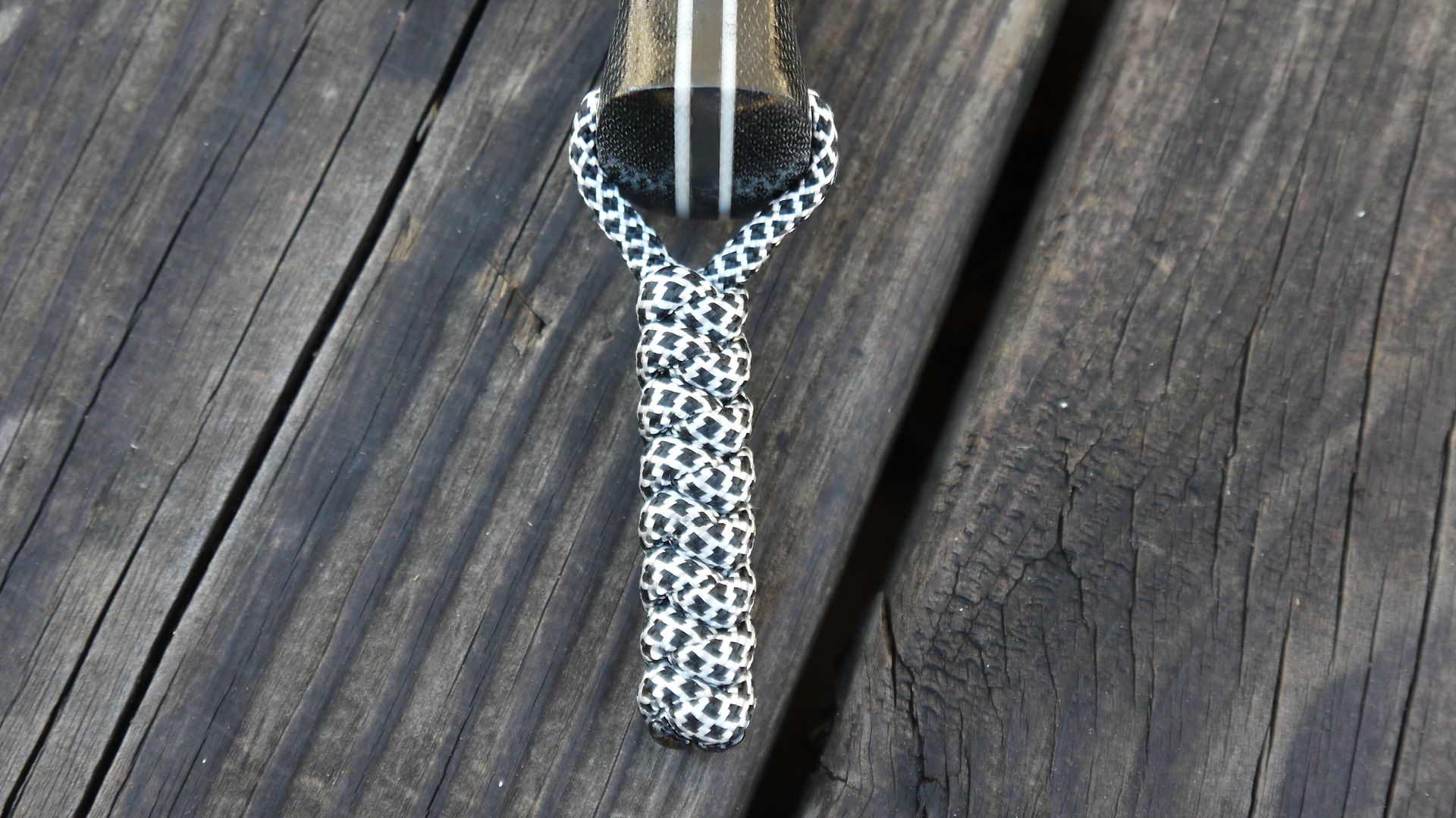

For all the Heads here, I've posted this on various forums, might as well share here too!
This one is my favorite of all the braids

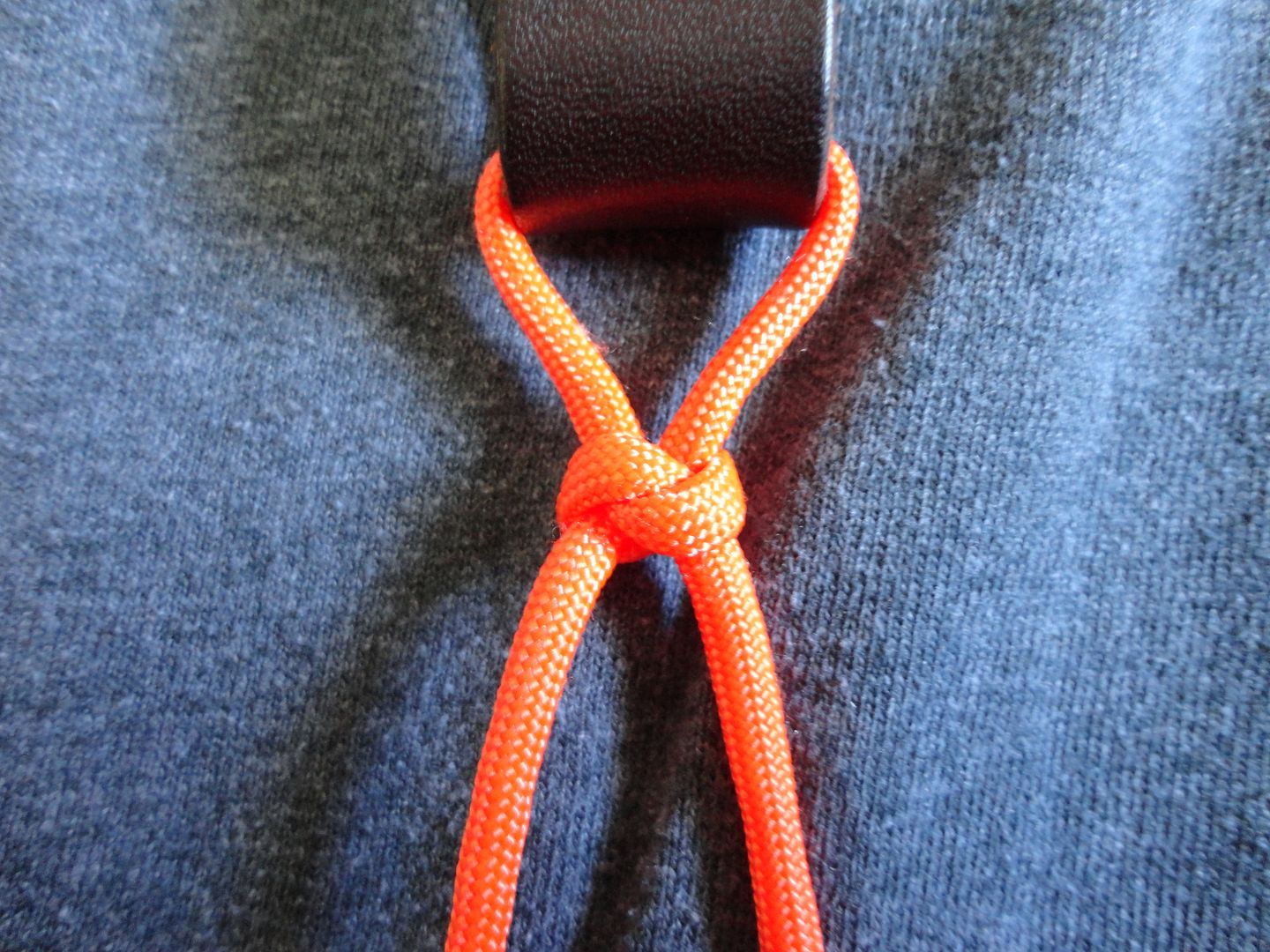

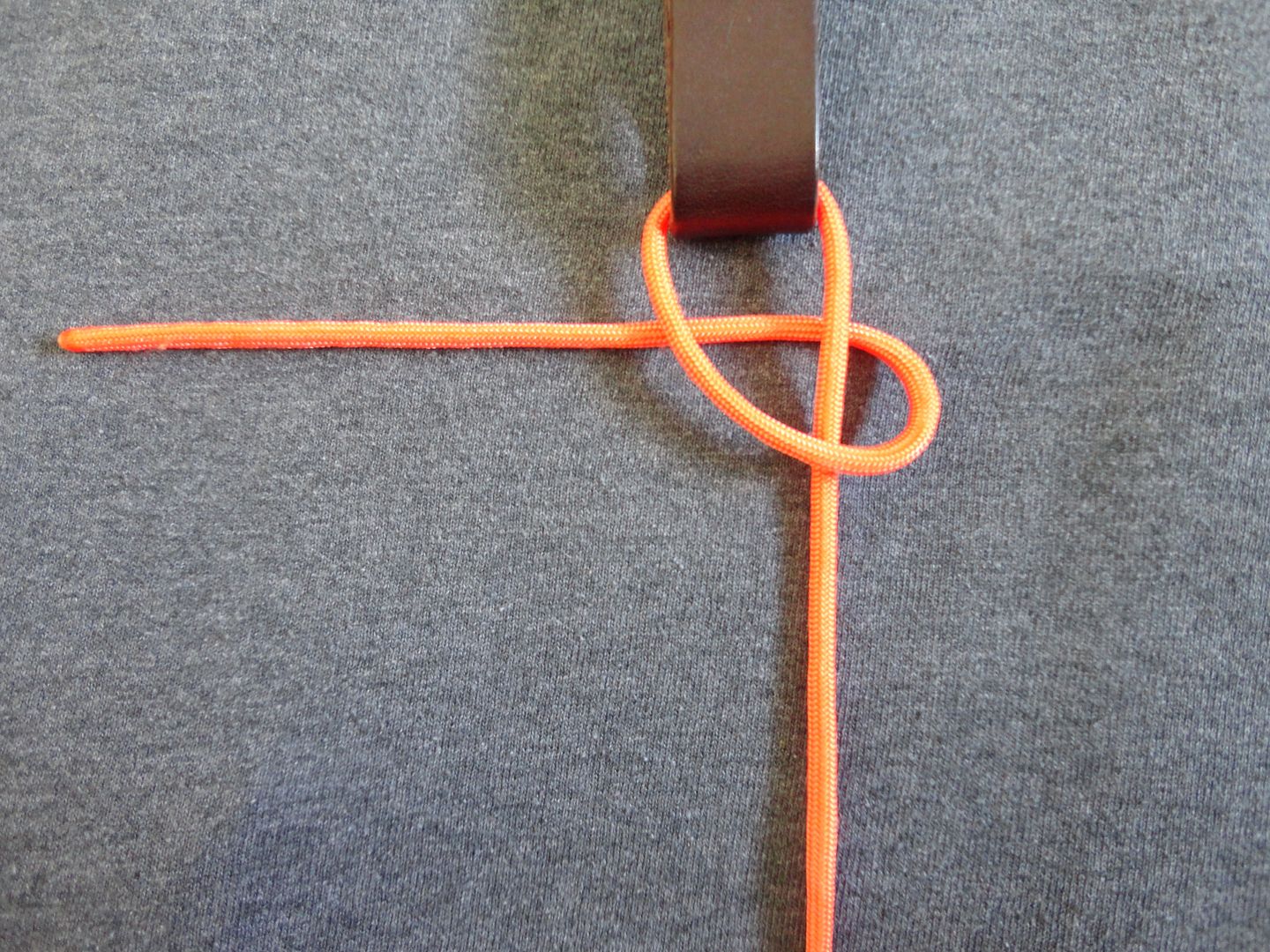

Start off like this

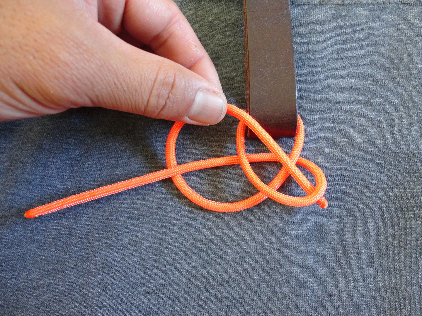

Take the left strand and wrap it over and under the right strand

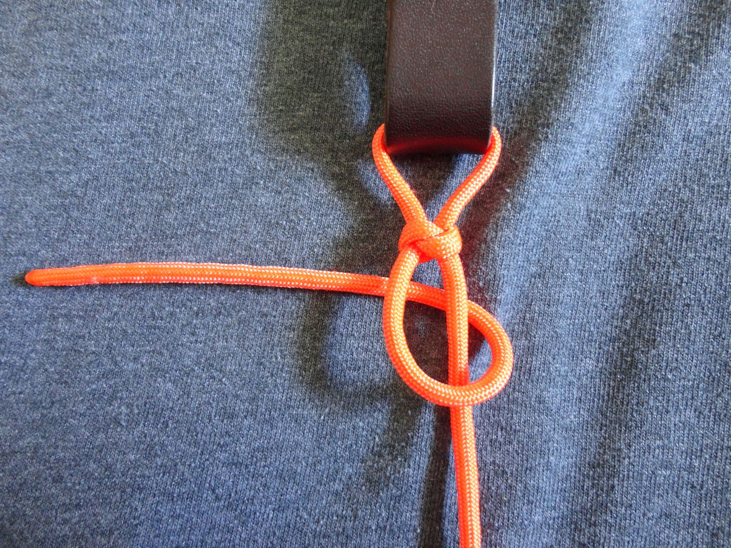

Take right strand and wrap it under the left strand

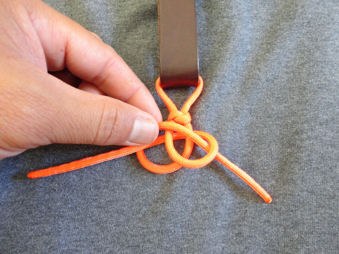

Take that same strand and put it through the loop you just created on the right side

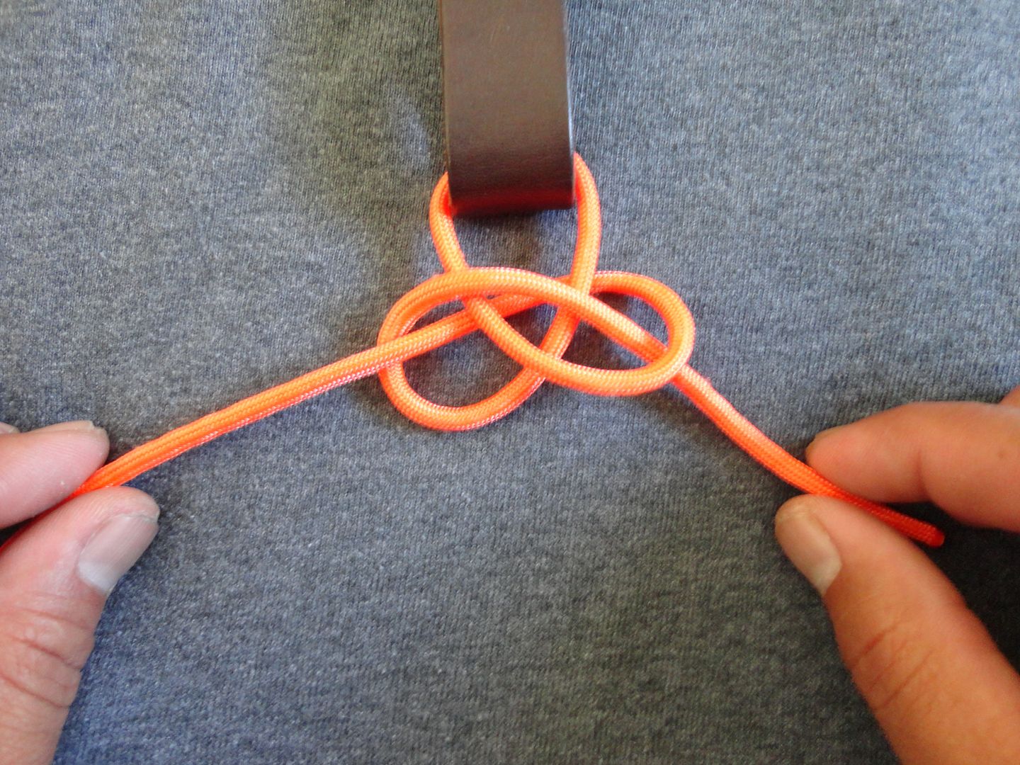

Carefully cinch down

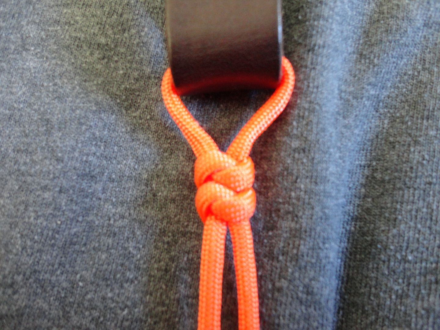

It should look like this when cinched

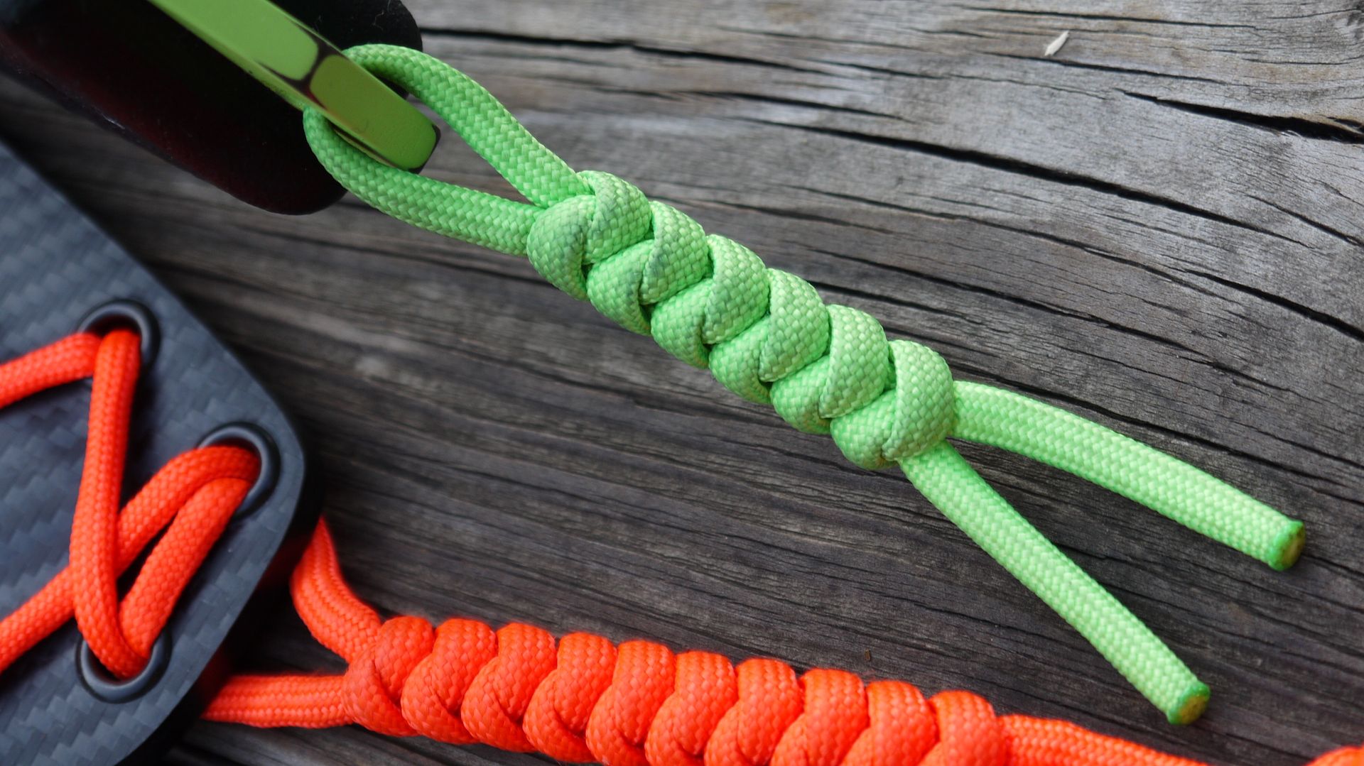

Repeat above steps
Just tie the same knot over and over again until you reach the length you desire!

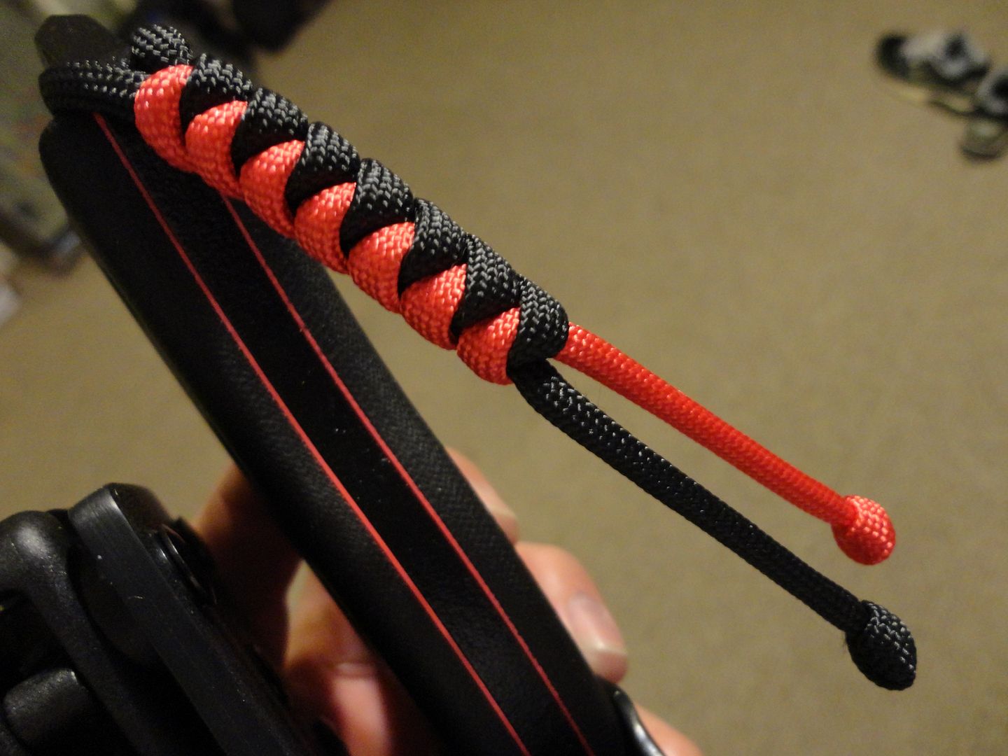

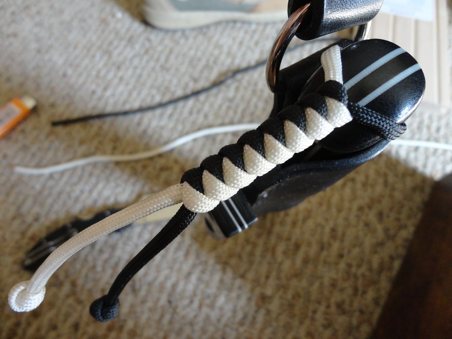

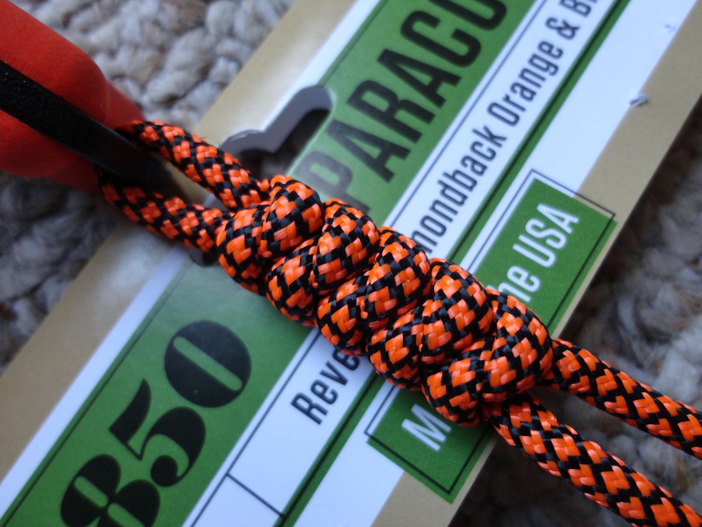

You can even do 2 colors with this one as well
Thanks bravo, I've watched a dozen videos and got nothing. Looked at your pictures and got it!!!

Thanks for the reminder. I really like the black and white!
