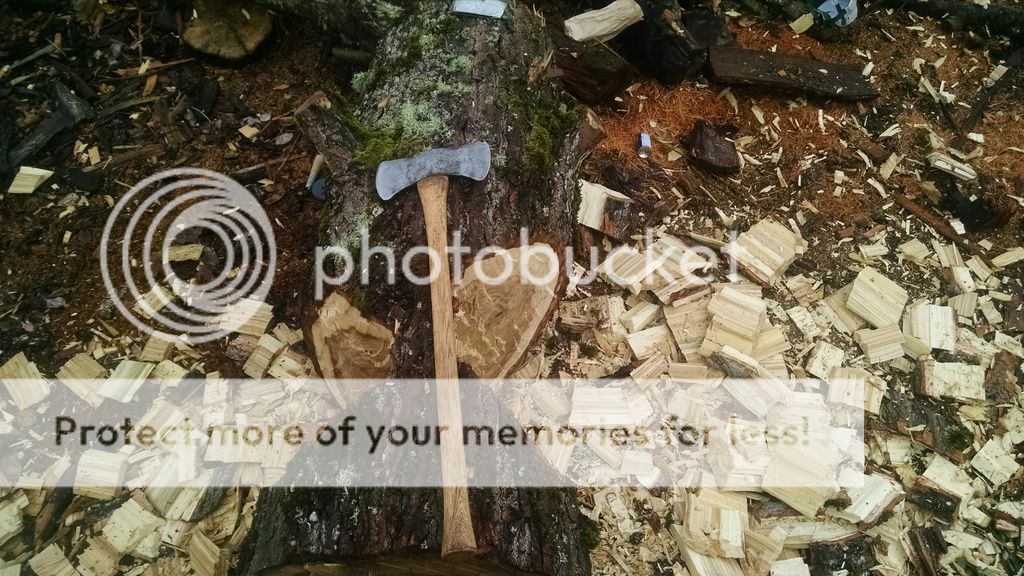

Pulled out my family axe, a Sears craftsman double bit I inherited from my grandfather.
3.5 lbs with a 36" haft
Funny story about this chip. My grandfather used this axe in freezing cold without warming the bit in his coat. I remember him telling me that lesson as a Young boy before he passed away.
I could sharpen it away, But I like knowing he put it there. :)
If my grandfather could only see.
But I look forward to my grandchildren swinging if I'm so lucky hahaha

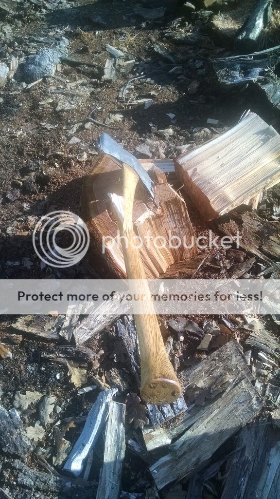

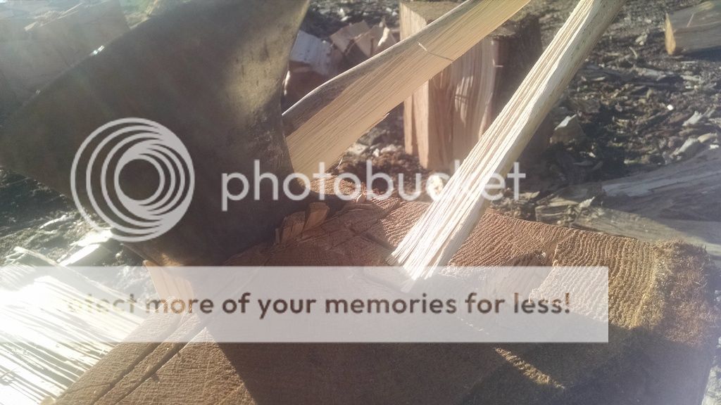

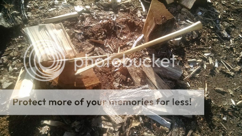

Broke my handle using the above technique on a knotty piece
So either the torquing will pop the wood or the handle hahaha
Posted on axe junkies
Learned about grain run-out.
This is also one of those flame hardened handles, less flex
Thanks for sharing that so we all can learn from it.
Yeah brother, anytime :)
Too much torque? Be careful out there!
It's never just one thing hahaha.
It was a combination of striking a knot. Torquing, using all the power I could muster, grain run out, flame hardened handle.
Haha heard a loud pop. And the handle went limp with the bit stuck in the knot.
I was surprised.
Haha just an excuse to get a new handle lol
That's a good way to look at it. Also fortunate that it failed at this time rather than standing on it to fell a tree from a high notch :D
