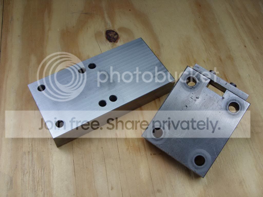

I made the investment in my first stamp. Was wondering if I could get some tips from those that have used one for years i.e. background material I put the blade on when stamping? Was playing with the amount of pressure needed to make a clean mark, noticed that if I do not hit it just right one side is lighter then the other.

JT, I've been using the same stamp for over twenty years and it's still going strong. when I first started with it my problem was not getting it right the first blow or having it jump and get shadow stamps. so I had a stamp jig made up. with this you can line up your blade, clamp it, and hit the stamp, you can then look at it and hit it again if you want, or next Tuesday, because the blade isn't going to move. the picture with the heat treated blade in the fixture is for reference, one strike on a heat treated blade an say good buy to an expensive stamp. hope these picture's help.
I don't use 'A stamp' per se but several letter stamps. I have a jig that holds them straight and use an Arbor press. Press down with the Arbor press making firm contact the strike the top of the press Arbor with a hammer. You can usually restrike with this method...
Agree with above, a jig is great. Those look great BTW BG.
