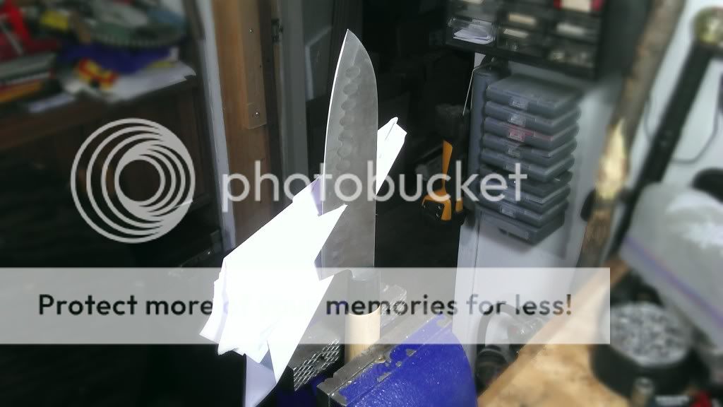

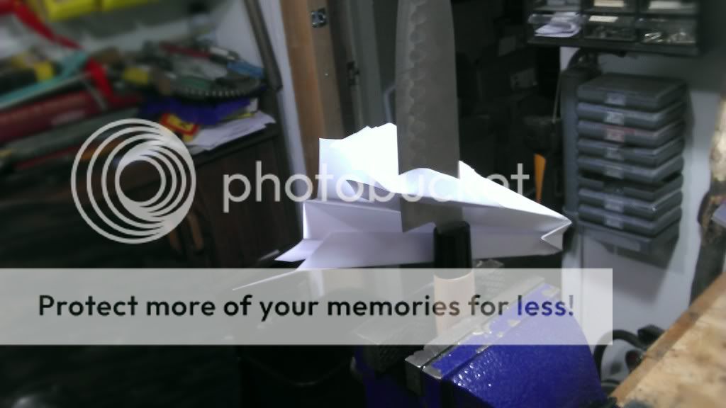

Answer #2 - When you can throw a paper airplane at the knife and either sever pieces of the plane off, or stick it on the edge... LOL! A fun test of sorts to try just for kicks.
Thrown from just beyond arm's length away to ensure easy hits but it still is a challenge to "catch" a throw on the blade!
Yep, that'll do it.
Color me impressed!!
