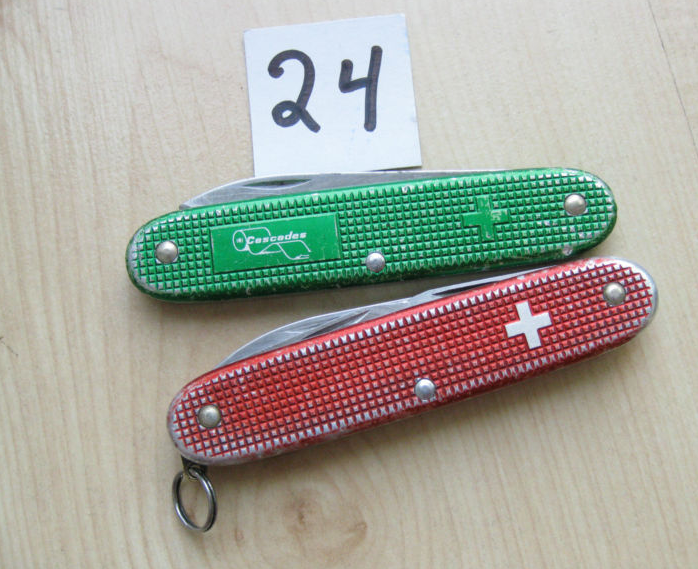

The color wears pretty fast on stock Vic anodize. I measure it around 35 RC. The hard anodize I run is around 55 RC. Ive even had some colored cadets straight from the factory that had nicks of color missing around the rivets or the sharp inside scale edges. So I would try just not to worry about it, it'll pocket wear pretty fast but the pocket work look is pretty nice anyhow.
You can only get so much durability from anodize anyhow though its still limited by the soft aluminum medium. You will barely notice the wear on stock silver scales though since its just covering up silver colored aluminum underneath.
Here are some very old very pocket worn scales I have from an ebay auction. Im going to strip them and give them a fresh coat of Red hard anodize.
