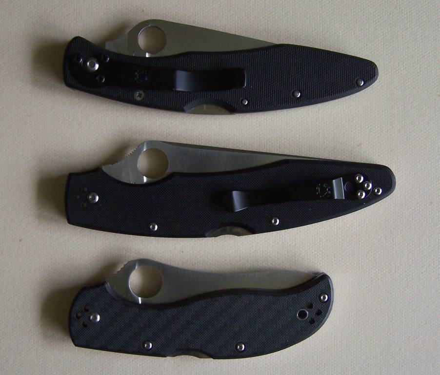

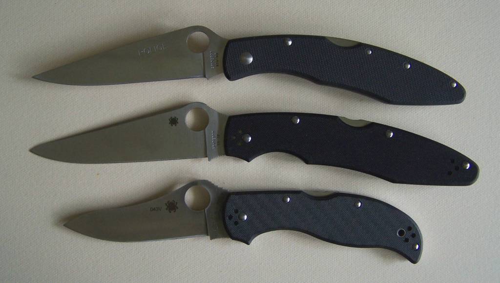

Took a couple pics this morning of the two, plus an original full flat grind G-10 Police...
...I consider the Stretch II a large folder, but the Police III makes it look almost like a toy. :eek: :D Those whole like BIG folders should find it an extremely attractive option.

The Deacon , your picture gave me more info than I dreamed of. Thanks.
Now that I see the police3 and streach2 , I wonder if the extra 3/4 of an inch in the blade is worth the 1 1/2 inches in the handle, for someone who has a streach2 I mean.
The stretch still has the best blade to handle ratio, right?
