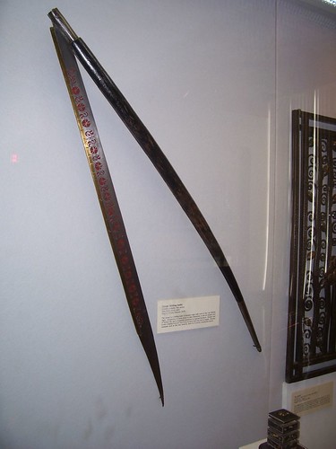

It sounds like you are suggesting something along the lines of a large navaja. The larger of these were for all practical purposes concealed swords.
The bottom one has an open length of 73 inches!
Link:
http://www.oriental-arms.com/item.php?id=2241

Neat! Did not know such a thing existed. The bottom one would have around a 36 inch blade I guess. Basically a regular size sword with an inconvenient handle.😃
