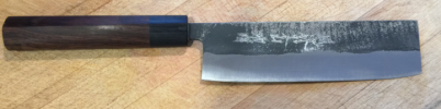

It appears that my choice of title for this thread was unfortunate. When I wrote "How", I meant "what geometry would you shoot for", NOT how you would technically grind the thing. I have absolutely no problem or hesitancy with doing this freehand on my grinder and keeping things sufficiently cool - I was only asking a question about what final appearances did the group think would be most appealing. I still think I would prefer to walk the shinogi back a little bit to create a more shallow primary bevel - but I will heed Stacy's advice to keep the shinogi where it is. I will post photos when done.

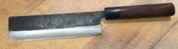

Alright folks - here is the result of this little venture. The grind went well: 120 grit ceramic, taking the edge down to 0.004-0.005" (the thinnest I can go without a coolmist ), then 220 grit ceramic, followed by A100 and A65 gators. During that grind, I barely nudged the shinogi at all. A "warning" to anyone who tries this (and you will see this in the photos below) - although protecting the blade with duck tape sounds like a good idea - I would NOT do so.
two reasons: it is REALLY hard to get the adhesive off of the blade in the vicinity of the shinogi. After multiple tries of fingernail pushing, goo-gone adhesive remover, really hot water, etc, I had to resort to scrubbing the stuff with a green scrubbie. two results: some scratches on the bevel (removed by minor touch ups with 120grit and up belts), and damage to the Kurouchi finish near the shinogi, which resulted in the need to push that shinogi back just a little in a couple areas to improve the look a little.
The second (the biggest reason), the adhesive on the duck tape is so aggressive it actually lifted the Kurouchi off of the blade in large areas on both sides of the blade. I would not have expected that the Kurouchi would be THAT delicate! I am not going to cry about this (all knives have history) and this is now part of its story - but others doing something like this should be forewarned. It is curious that anything unexpected here did not happen during the grinding - but was due to other stuff :-( . Photos below. (this knife is now sharper than it ever was...
You DO realize, though, that this now begs the question of whether I do a light flat grind to get rid of the Kurouchi while keeping some semblance of the makers mark. But that is a different discussion.....
I know you already did it, but IMO nakiri are typically thin already, so no need to grind the shinogi line a lot higher unless it had been sharpened enough times to lose a lot of height from cutting edge to the spine.

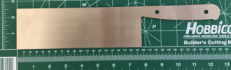

How do you like this nakiri? It seems to have a lot more curvature, especially towards the heel, than most knives I have looked at. I am planning to make a nakiri and would like to know what you will change when making your own.

If I grind the Kurouchi I would just go for a clean metal finish. There are many out there, I believe, that consider the Kurouchi an inferior finish (certainly, they seem to be much less expensive that their clean metal counterparts. I am going to think about this for a while - see how much looking at the finish bugs me :-)
I really like this nakiri. It came from the maker with this amount of curvature. I flattened it just a little during this regrind - but not much. Although it may not "look" as nice, I tend to like more curvature than less because, with repeated sharpenings, it is easier to avoid creating concave sections on the blade. Also, I consciously try to use more "slicing" motions than up and down "chopping" motions because slicing just cuts the food better and easier. With that slicing motion, with a little bit of rocking of the blade at the same time, the edge curvature is a non-issue. re. balance" most of my japanese knives have magnolia handles, whereas this one has a heavier wood more like a dense tropical. I like the feel and balance of that heavier handle much more than the magnolia handles. If I have any concerns with this nakiri, it is that its length sometimes does not allow me to take a single long pull stroke when slicing. As an experiment I created a pattern which I have described as a "modified nakiri" - slightly longer and wider blade (image below). longer to allow more slicing motion, wider to facilitate scooping up of cut food. I made one of these for my son, and this second blank I am going to grind and try for myself. I really do not know whether I will like the feel of this modified version better or worse than the typical pattern though..... Not sure if that helps you?
Hubert - just a couple more thoughts re. "what I would change". I have really moved more towards reaching for a different knife, depending on what I am going to do/cut. If I am prepping a relatively small amount of vegetables, I go right for that nakiri. If I am prepping a large amount of vegetables, I reach for a chinese cleaver (similar to the nakiri, but bigger in all dimensions.). If I am prepping meat (or tofu) I will reach for a santoku. So, if you follow that kind of pattern, the existing design of that nakiri is great, if you are doing relatively small prep jobs. for me though, I would keep the handle on the heavy side (the modified version above has a western handle, which was for my son - i personally prefer the Wa "D" style handle..... Again - I hope that helps a little.....
Cushing, thank you for all the details. I have some 2" wide stock (1/16" AEB-L) that I was planning to use. I don't use a heavy cutting board, so I just lift the board and slide whatever I am cutting into a bowl or directly into the pot or pan. I have a bench scraper for scooping but hardly every use it for anything other than dough.
I drew a pattern for a nakiri a little while ago with very little curvature. I have since googled a little bit and found a post by Stacy where he recommended some curvature. It makes sense. I am still a bit unclear about how to grind the bevels on such a thin knife that is about 2" wide.
