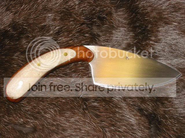

Ditto everything that J Mac said. You want to keep that stuff cool. besides not ruining the temper, burning your fingers gets really lame after a while!!:D One thing that works for your basic shape is to cut out a template out of cardboard or something fairly stiff, like 1/4 ply and actually handle it to see if your handle design is sound. Go crazy, draw and cut whatever pops into your head and see if it could work. No possibilities for hot spots, and hand slippage. Dont be afraid to come up with your own shapes and designs. Cut em out of cardboard or ply, and see if it could work. Not to imply that I am some master knifemaker as I have only been making knives for 6 months, but I use pretty much only shapes that I come up with in my head for paring, fillet, skinner, and slicer knives. For a drop point shape, this is what that would look kinda like. I couldve ground the tip down a little further to add to the "drop" but thats the way it came out. Now how thick to grind, what sort of grind on the blade, well that depends on what you want to use it for. Whole different ball game. The other professiolnals in the forum can help you there. I plan to stick to non heavy abuse, non chopping type knives till I learn more on that myself.

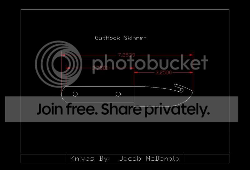

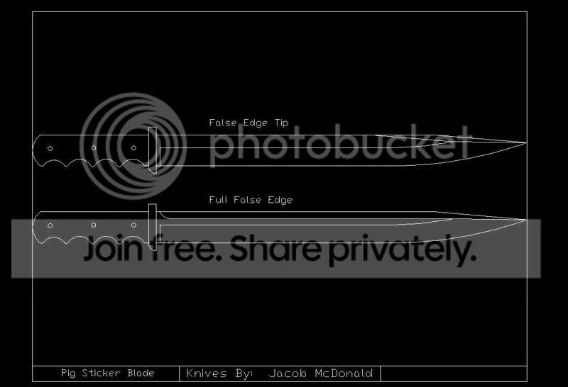

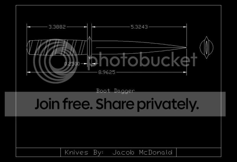

thats more of a skinner than a drop point IMHO. but im no expert on knife patterns. i just draw what comes to my head. heres a few cad drawings i did. be warned they are a little rough but it shows the basic idea.
hope some of these help inspire you. have fun and be safe. always wear a face shield and a respirator.
