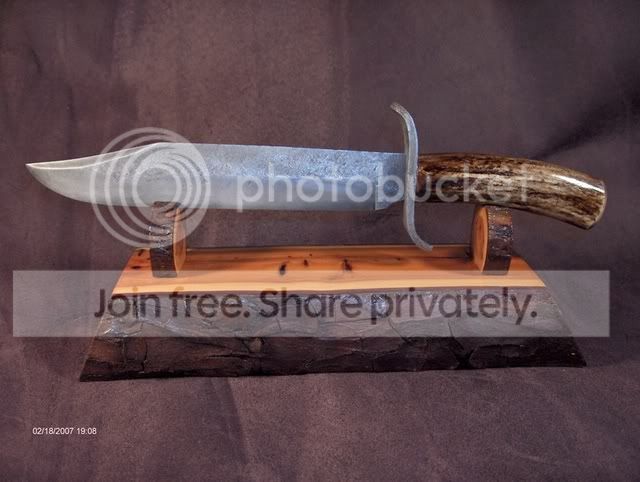

This one was forged from 1084 and finished with regular and stone files along with some pumice rubbing. The guard was forged from wrought and hand filed and sanded. The only power equipment used was a bench drill press.
