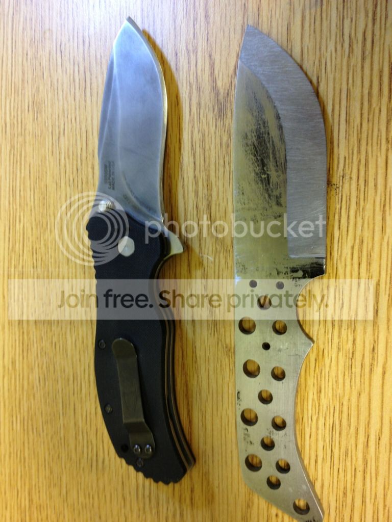

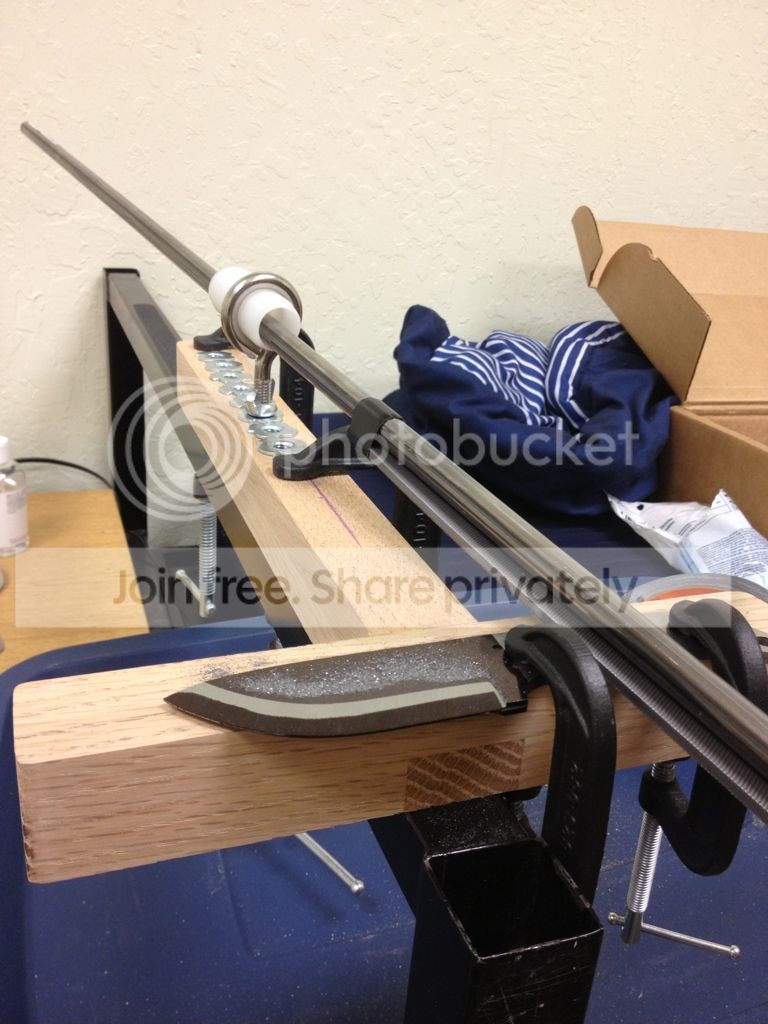

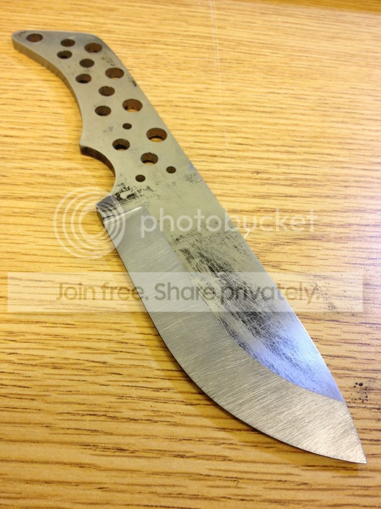

Howdy knife-makers. I recently procured some tools and some of Aldo's 1084 in hopes of making some knives. I've been wanting to do this for a long time and i'm having a blast so far. The knife i'm working on seems to be going well. I am quite proud of my filing jig. It is by no means an original design, but it works well, is precisely adjustable, and is also quiet thanks to the nylon piece you see the guide rod going through. Quietness is important to me because I live in barracks and don't want to disturb my neighbors. I know the grinds aren't perfectly straight but i'm in the process of taking the grind back further. I'm shooting for a 3/4 flat grind. Let me know what you think of the blade so far.

Your filling jig looks awesome! Much better then mine.
What file do you use for it?
The bevel nice and straight as well as symetrical.
BTW, the plunge line looks very straight (90 degree corner). A rounded edge is better.
the file jib is awesome. well done with that sir.

and i would also bring the bevel up higher.
I do plan on raising the bevel quite a bit almost to a full flat grind. Its currently around 8°
Looking good so far. Only word of advice would be to get a round file and hit the plunges before you start your bevel. Take them up to almost where you want your bevel to be. Atleast in my experience when I wait to round them out its very difficult not to get down into your edge area and to not end up with a divot running up just in front of your plunge.

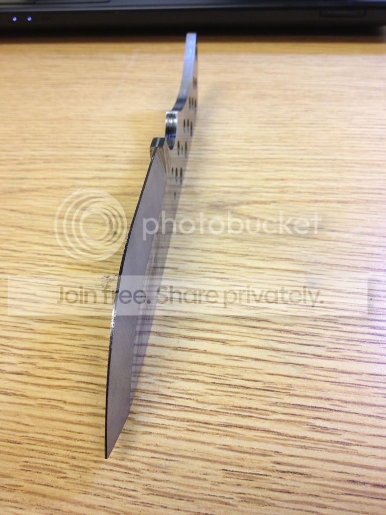

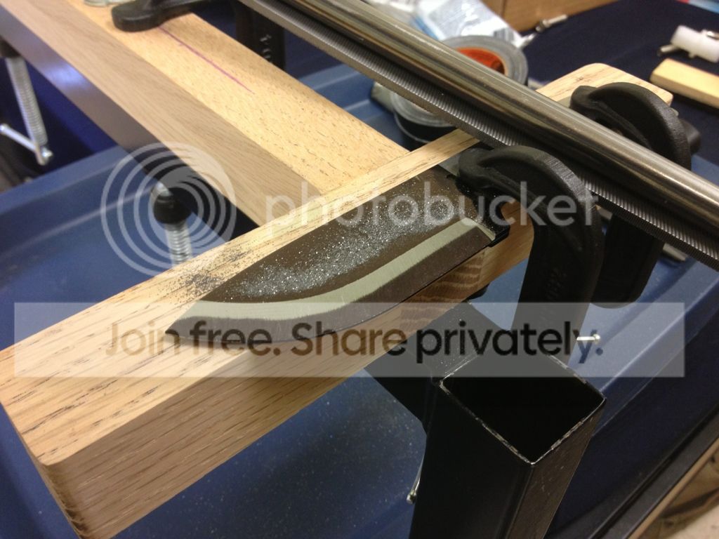

Thanks for the encouraging words guys. I've run into a bit of an issue however. In raising the grind height it seems i got a bit happy with the file and ground a little too deep on one side. In order to even them out i think i'll end up with too thin of an edge. I had to quit working for the day but my plan is to even out the other side and see if the edge is too thin at that point. If it is I'll probably have to take a bit of material off the belly line so it is thicker.

Most everyone recommends taking the edge to the thickness of a dime, 0.040-30", before heat treat. However, many people go thinner than that. Your edge looks pretty thick in the pictures. With a flat grind you should be ok with as thin as 0.020"
do you have a link for that Jig? was thinking of making something like that for my table top workshop.
it looks pretty straight forward. two pieces of hard wood, and some eye bolts. one 1/2 rod. add some patience. ...jig.

Search YouTube for Arron Gough he has a tutorial for making one and he explains it very well
Off to a good start. Some good tips have been given to you already. I'll ad another.
You can sand the file marks out of the bevels in the same jig. Just wrap the file in sand paper and go at it with progressively finer paper. Definitely want to get it all smooth before HT. Getting out scratches after HT is not fun
HA. actually found that on youtube about 30 seconds after i asked you. yours definitely has your personal touches to it compared to his. but i like them all.
