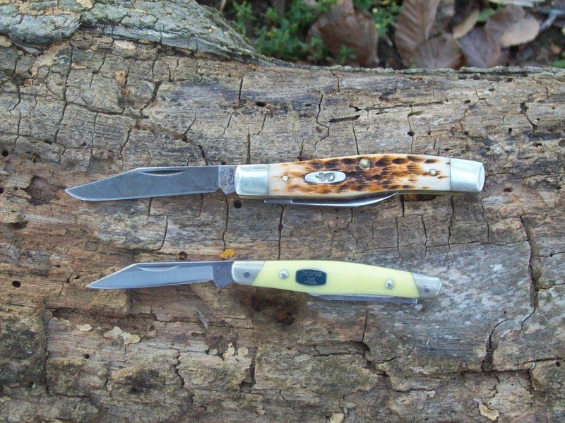

just because this thread needs more pics :D
these are the knives in question
and i have been taking you folks's advice and i am much happier with my 309, not QUITE where i want it to be, but much closer :D
