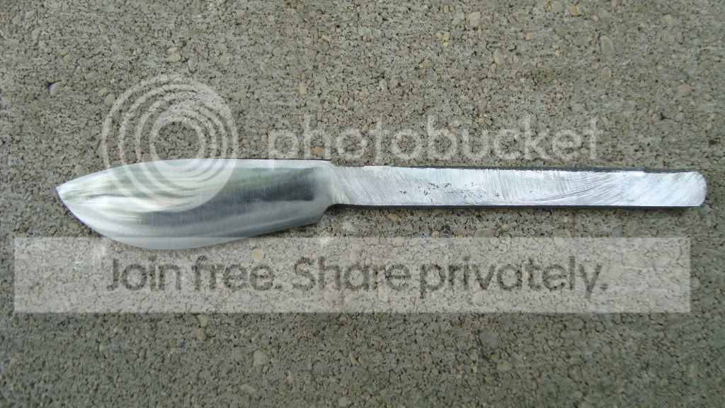

On a side note I have a few scrap pieces of 5160 kicking around so while I was waiting for the coating to set up on the forge I decided to play around with the scrap pieces and my little 30X1 grinder and made this on the first try
blade length is 2.25" with a full convex grind. I think I will keep it and if I can get some heat out of the little forge I will HT this one as well. It looks shine because it is, I didn't want to waste new belts playing around so I used a worn 80 and 120 to play with.
